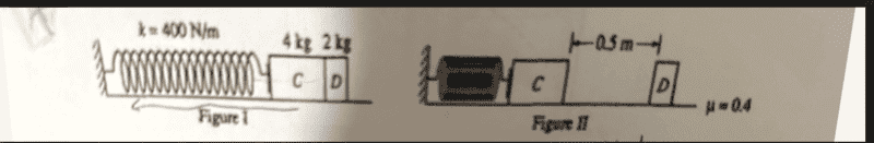

A massless spring with force constant k = 400N/m is fastened at its left end to a vertical wall, as shown in figure 1. Initially, block C(mass m_c =4.0kgs) and block D )mass m_D=2.0kgs) rest on a rough horizontal surface with block C in contact with the spring (but not compressing it) and with block D in contact with block C. Block Cis then moved to the left, compressing the spring of a distance of 0.50m, and held in place while block D remains at rest.
a) Determine the elastic energy stored in the compressed spring.
Block C is then released and accelerates to the right, toward block D. The surface is rough and the coefficient of friction between each block and the surface is 0.4. The two blocks collide instantaneously, stick together, and move to the right at 3m/s. Remember that the spring is not attached to block C. Determine each of the following.
b) the speed v_c of block C just before it collides with block D
c) the horizontal distance the combined blocks move after leaving the spring before coming to rest.

Have I done it right?

Part c has some issues. The problem dictates the blocks have speed 3 m/s instantaneously after collision. You are supposed to find how far they have traveled after all that kinetic energy has been converted to heat.

What is the kinetic energy of the blocks immediately after the collision? The force of friction does that much work in stopping the blocks.
The kinetic energies of the blocks after collision is #\frac{1}{2}(m_1+m_2)v_f^2##. That’s what I’ve written in post #1.
Correct, but you have the initial KE as ##\frac{1}{2}m_1v_c^2##? You are kind of (incorrectly) working before and after the collision, when you should be working entirely after the collision has occurred until both masses have no kinetic energy.

I think you are missing the point. block C is moving with the block D at 3 m/s initially. You are getting mixed up with energies before and after the collision, when you need to only consider what is happening after the collision. They are indirectly telling you how much energy was lost instantaneously in the collision, by telling you the stick and move together at 3 m/s, but it is of no consequence to the question posed in part c.

Okay I understood what mistake I'm doing,
$$ K.E_i = K.E_f + W_NC$$
$$\frac{1}{2} (m_1+m_2)v_f^2 = 0+ \mu g(m_1+m_2) d$$
$$ d= 1.15m$$
