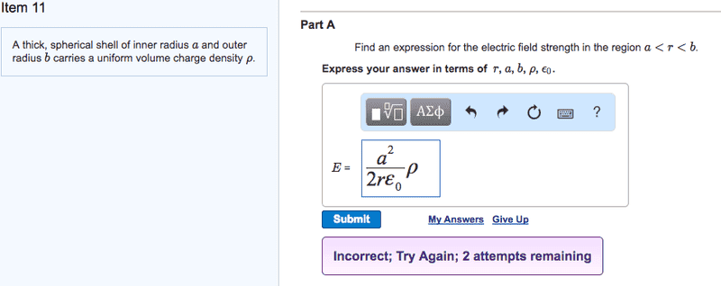

A thick, spherical shell of inner radius a and outer radius b carries a uniform volume charge density ρ.
Find an expression for the electric field strength in the region a<r<b.
Gauss's Law ∫E⋅dA
Area of a sphere
I know I am really close to the answer, but I do not know what I am doing wrong. I know that there are two radii, but how do I find the electric field strength with these. I think I am close, but may be way off too. Can someone guide me to the way of solving this.

Ok this is my attempt: (1/4πr^2)*(Qenclosed/ε0) = (1/4πr^2)*(πa^2/ε0) = (1/4r^2)(a^2/ε0). Correct?
How did you determine Qenclosed? I don't see the charge density ρ used, and a measure of volume should involve the cube of a radius (or two). Perhaps you should show in detail how you determined Qenclosed.

Sorry I didn't write it down, but the problem states to "Express your answer in terms of r, a, b, ρ, ϵ0." It was in the picture.
Also it says "A thick, spherical shell of inner radius a and outer radius b carries a uniform volume charge density ρ."

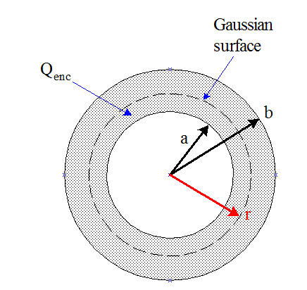

I think you're choosing the wrong volume for the charge that's enclosed within the Gaussian surface. The variable b should not appear anywhere in the answer.
The shell you're interest in lies between radii a and r. It's labelled Qenc in the figure above. It is within the Gaussian surface, hence "enclosed".

Right. And similarly, the volume of a sphere of radius a is (4/3)πr3.
The sphere of radius a happens to be the volume of the empty cavity within the shell. So the volume of the shell from a out to r is equal to the volume of the solid sphere of radius r minus the volume of the sphere of radius a (you're removing the volume of the cavity from that of a solid sphere).

So ((4/3)π(r3-a3))/(4πε0))ρ.
  • #32
Close. You're missing the r2 in the denominator that belongs to the Gaussian surface area. Then you can cancel the 4π's that are common to the numerator and denominator.
  • #33
Ok so that would mean it becomes (r3-a3)/(3ε0r2))ρ?
  • #34
Yes, that looks good.
