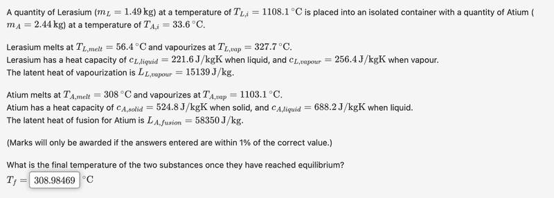

A quantity of Lerasium (mL=1.49kg) at a temperature of TL,i=1108.1∘C is placed into an isolated container with a quantity of Atium (mA=2.44kg) at a temperature of TA,i=33.6∘C.
Lerasium melts at TL,melt=56.4∘C and vapourizes at TL,vap=327.7∘C.
Lerasium has a heat capacity of cL,liquid=221.6J/kgK when liquid, and cL,vapour=256.4J/kgK when vapour. The latent heat of vapourization is LL,vapour=15139J/kg.
Atium melts at TA,melt=308∘C and vapourizes at TA,vap=1103.1∘C. Atium has a heat capacity of cA,solid=524.8J/kgK when solid, and cA,liquid=688.2J/kgK when liquid. The latent heat of fusion for Atium is LA,fusion=58350J/kg.
What is the final temperature of the two substances once they have reached equilibrium?

But this isn't correct and I am not sure where I am making an error. Could someone please look at this and let me know?
Thank you

It seems to me that vapor is the initial condition of that 1.46 kg of Lerasium, since its temperature is above 327.7 °C.

Q1 = 1.49kg⋅256.4J/kgK⋅(1108.1−327.7)K
Q1 = 298140.8944
Q2 = 1.49kg⋅15139J/kg = 22557.11J
Q3 = 1.49kg⋅221.6J/kgK⋅(327.7−56.4)K
Q3 = 89578.9192
Q4 = 2.44kg⋅524.8J/kgK⋅(308−33.6)K
Q4 = 351372.4928
Q5 = 2.44kg⋅58350J/kg = 142374J
QL,total = Q1 + Q2 + Q3
QL,total = 298140.8944 + 22557.11 + 89578.9192
QL,total = 410276.9236
QA,total = Q4 + Q5
QA,total = 351372.4928 + 142374
QA,total = 493746.4928
Since QL,total < QA,total we get
QL,total = Q4 + mA⋅cA,liquid⋅(Tfinal−308)
410276.9236=351372.4928+(2.44)* (688.2)* (Tfinal-308)
Tfinal = 343.079 °C.
This is still not the correct answer. Is there something I am missing?
The calculation of Q3 incorrectly assumes that the substance was cooled down all the way to the melting-solidification temperature (which is lower than the estimated equilibrium temperature of both substances).
In the same way, the calculation of Q4 assumes that the originally solid Atrium reached its melting point (which could be or not, depending on the accuracy of the balance temperature estimation).

I would put it into a spreadsheet. Easiest for the formulas is to put temperatures on the x axis and heat transferred on the y axis. Where they cross is the answer.

Yes that makes sense. Thanks I got it now
