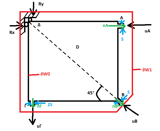

Air of pressure $p_0$ and velocity $|\overrightarrow{u}_{A}|=|\overrightarrow{u}_{B}|=c$ enters the space $D$ from the sections $A, B$ of surface $S$. If at the orifices the distribution of the pressure and the velocity is uniform and at the exit $\Gamma$ the pressure is equal to the atmospheric one $P_a$, find the forces $R_x, R_y$ acting on the support $\Delta$ (air density $\rho_a$).

How we have we found that $\overrightarrow{n}_B=\frac{\sqrt{2}}{2}(\hat{i}-\hat{j})$ ?? (Wondering)
Could also explain to me how we have calculated the integrals $\int_{\partial{W_1}}p\overrightarrow{n}dA$ and $\int_{\partial{W_1}}\rho \overrightarrow{u}(\overrightarrow{u}\cdot \overrightarrow{n})dA$ ?? (Wondering)

Why does it stand that $R_x+F_{W_0, x}=0$ and $-R_y+F_{W_0, y}=0$ ?? (Wondering)
Hey! (Wave)
The wall is fixed and the system presses itself into the top left corner.
That means that $R_x$ and $R_y$ will be exactly as large as needed to counter the forces generated by the fluid.
Put otherwise, the system as a whole is in static equilibrium (what they termed "Balance of the system").
That means:
$$\sum F_x = 0\\
\sum F_y = 0 \\
\sum M = 0$$
(Thinking)

What is $M$ ?? (Wondering)
Could you explain to me the signs at the equation $-R_y+F_{W_0, y}=0$ ?? (Wondering) Why is at $R_y$ a minus and at $F_{W_0, y}$ a plus?? (Wondering)
More specifically, static equilibrium is often written as something like:
\begin{aligned}
\overset{+}{\rightarrow} &\sum_i F_{i,x} &=0 \\
+\!\!\uparrow &\sum_i F_{i,y} &=0 \\
\underset+\curvearrowleft &\sum_i M_{i,\text{arbitrary point}}&= 0
\end{aligned}
The arrows indicate which direction we count as plus.
Since the direction of $R_y$ (as it is drawn) is in the opposite direction of the arrow for vertical forces, we give it a minus sign.
Apparently $F_{W_0, y}$ is going in the direction of the arrow (up), although I don't see it in the drawing. (Wasntme)
Which force is $F_{W_0, y}$ ?? (Wondering)
From the problem statement:
[box=yellow]$\overrightarrow{F}_{W_0}$ is the force over the solid boundary $\partial_{W_0}$ (square ΑΒΓΔ) [/box]
That is, the force $F_{W_0, y}$ is the vertical component of the force that applies to the box due to fluid movements caused by differences in pressure.
