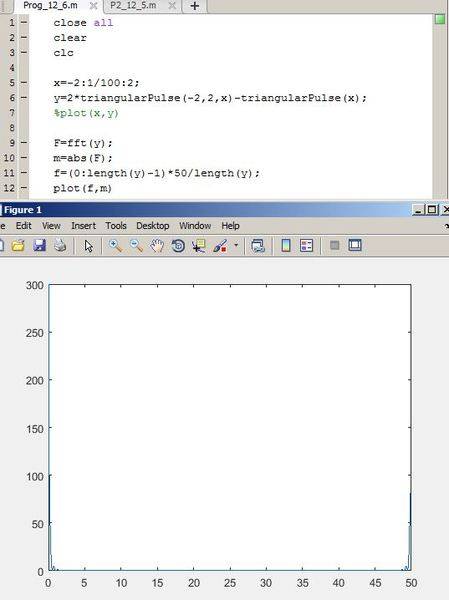

Find Fourier transform and plot spectrum by hand & MATLAB
In summary, the given function is ##y(t) = 2tri(\frac{t}{2})-tri(t)## and the Fourier transform of this is ##\mathrm{sinc}^2(2f)-\mathrm{sinc}^2(f)##.

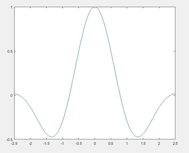

Therefore FT of y(t): ##2\mathrm{sinc}^2(2f)-\mathrm{sinc}^2(f)##
Which produces the following graph:
Link: http://i.imgur.com/7iJhEdi.jpg
Is this right? I'm concerned that the graph has values below the x-axis. Should the graph of the transform match the graph of the given function?
There is absolutely no problem with Y(f) being negative or complex, the energy at frequency f is proportional to ##|Y(f)|^2##.
