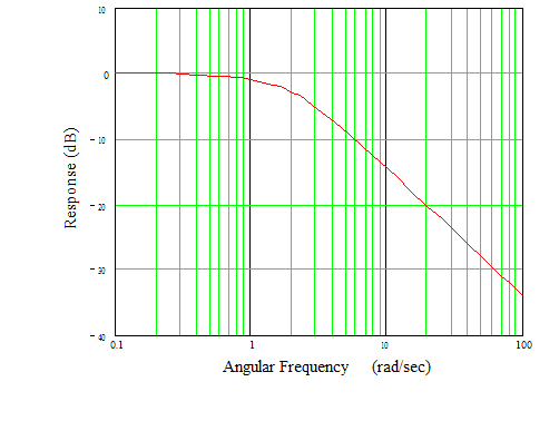

We are given that system of 1st grade
1/2 * dy(t)/dt + y(t) = x(t)
1) We need to find frequency response { H(w) }
2) We need to find circular frequency -3dB
3) We need to find the absolute value of H(w) in dB for frequency f = 3/π Hz
2. Homework Equations
(log is always with base 10)
Convertion to db => db = 20log(|H(w)|)
circular frequency = -3db => |H(w)|{w=-3db} = 1/sqrt(2) * H(w){max w}
Y(w) = H(w) * X(w)
[/B] I solved the 1st one with that way.
(take Fourier) => 1/2* jw*Y(w) + Y(w) = X(w)
(divide with X(w)) => 1/2* j*w*H(w) + H(w) = 1 => H(w) = 1 / (1/2 * j*w + 1) => H(w) = 2 / (2 + jw)
For 2nd I don't know what is w = max, and for 3rd I did an attempt but I found wrong result.
My book gives as answer for 2nd the value = 2rad/sec, and for 3rd the value -20dB.
If anyone can help me with the procedure of solving I would be happy.
Thanks in advance !
Hepic said:
what is w = max
For a first order system the "maximum response" is if dy/dt = 0 so for ##\ \omega = 0##.
Hi Hepic. You should be able to recognize your transfer function H(ω) as that of a typical first order low pass filter.
As such you can find the -3dB frequency by inspection of H(ω) itself, or if you want to do the math, determine ω that makes |H(ω)|2 = 1/2, i.e., find the half-power point.
I find myself disagreeing with the book's answer of -20 dB for the response at 6 rad/sec. A first order low pass filter should decline at a rate of 20 dB per decade after the corner frequency (using the straight-line curve fit approximation). Now 6 rad/sec is not a decade past 2 rad/sec. I'd expect something closer to -10 dB for the response at 6 rad/sec.
Yes - it is exactly a value of -10 dB.
