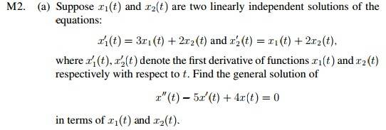

Suppose ##x_1(t)## and ##x_2(t)## are two linearly independent solutions of the equations:
##x'_1(t) = 3x_1(t) + 2x_2(t)## and ##x'_2(t) = x_1(t) + 2x_2(t)##
where ##x'_1(t)\text{ and }x'_2(t)## denote the first derivative of functions ##x_1(t)## and ##x_2(t)##
respectively with respect to ##t##.
Find the general solution of ##x''(t) + 5x'(t) + 4x(t) = 0## in terms of ##x_1(t)## and ##x_2(t)##.
The general solution of the equation
##x''(t) + 5x'(t) + 4x(t) = 0##......(1)
is
##x(t) = c _1 e^{-4t} + c _2e^{-t}##......(2)
Now if i want to express equation (2) in term of ##x_1(t)## and ##x_2(t)## , what exactly i have to do ?

I'm guessing that that equation is supposed to be ##x''(t) \color{red}{\bf -} 5x'(t) + 4x(t) = 0##

sorry guys . i was wrong about the question .. i found the question and i am attaching the question's image
So why did you tell me the equation was correct, without checking it, when I asked about it? And when are you going to show us how you solve the 2x2 system?

This looks correct, and this is where your problem becomes confusing. Your 2x2 system is a vector system of the form$$
\vec x' = A\vec x$$where$$
\vec x'=\left(\matrix{x_1(t)\\x_2(t)}\right)' = \left(\matrix{3 & 2 \\ 1 & 2}\right) \left(\matrix{x_1(t)\\x_2(t)}\right)$$and you have a general solution$$
\vec x = c_1e^{4t} \left(\matrix{2 \\ 1 }\right) +c_2e^{t} \left(\matrix{-1 \\ 1 } \right)$$You could write this as$$
\vec x = c_1\vec x_1+c_2\vec x_2$$where$$
\vec x_1 = \left(\matrix{2e^{4t} \\ e^{4t} }\right),~~\vec x_2= \left(\matrix{-e^{t} \\ e^{t} } \right)$$Writing it this way, you have two linearly independent vectors forming a basis for your vector solution. Don't confuse the vectors ##\vec x_1,~\vec x_2## with their components which you are calling ##x_1(t)## and ##x_2(t)##.

When you talk about the two linearly independent solutions of those two equations, you would be talking about the independent vectors we have above. But the general solution of your second order equation would be a scalar, not a vector. So at this point, it isn't clear to me what the question is really asking for. You might have to ask your teacher to clarify this.
My understanding is that you are not meant to solve any equation explicitly. (Even though it is not hard to solve any of them.)
My suggestion is to add the first two equations, and you will then see that you have a simple differential equation in a new variable.
Maybe you can then see that the third equation is really the same differential equation again but in yet another variable.
The problem statement seems strangely worded. I'd guess the intent is to solve for ##e^{4t}## and ##e^t## in terms of ##x_1(t)## and ##x_2(t)##.
