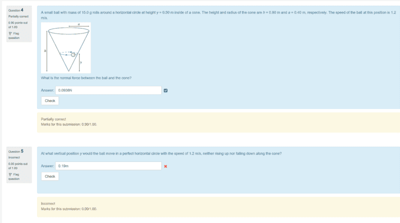

f=ma
v^2/r
I am confused about this question because i am not given an angle theta for the normal force on the ball.
My x component has only the normal force, my y component has only the gravitational force.
I set my y component to 0 (because the ball would be going neither up or down) and just get -mg = 0
So i am confused here on what to do. Need a hint
ok i figured it out, i had to take the tan inverse to find the angle. i didn't think it through enough so the height was .15meters, i still do not know why i am only getting partial credit (0.90/1.00) for the top question
Ok i actually figured out the top one too i will mark solved now
You have the correct answer for the second part. I think there is something wrong in the problem statement for the first part. Notice that it says the height is .5m and the speed is 1.2m/s. This is inconsistent with the answer for the second part.
Likes isukatphysics69
