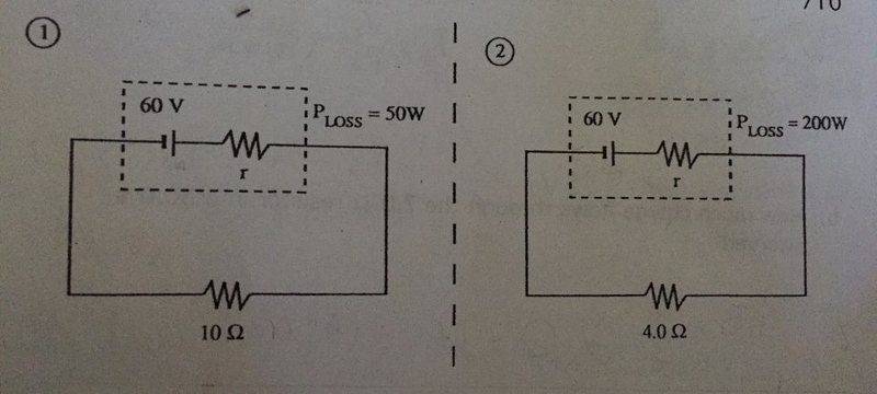

A battery with an emf of 60 V and an internal resistance (r) is connected to a 10 ohm external resistance. The power lost inside the battery is 50w. The same battery is then connected to a 4.0 ohm resistance. The power loss is 200w. What is the internal resistance of the battery?
V = emf - Irint
P= VI
V= IR
P=I^2R
P= V^2/R
P= V^2/R
V= √ PR
V= √50 x 10
V= 22.36 V
I= V/R
= 22.36/ 10
= 2.23 A
Rint= emf - V/ I
Rint= 60 - 22.3/ 2.23
= 16.9 ohms
This is obviously wrong and I didn't even incorporate the second circuit yet. I'm pretty sure I could finish this question if I knew how to start. Any help is appreciated :)
Please show your work. Do not just describe it with words.
Your calculation of V is incorrect. 50w is the power dissipated in the battery yet you used the value of the external resistor.
Note there is a difference between "power delivered" by the battery and "power dissipated" by the battery.
