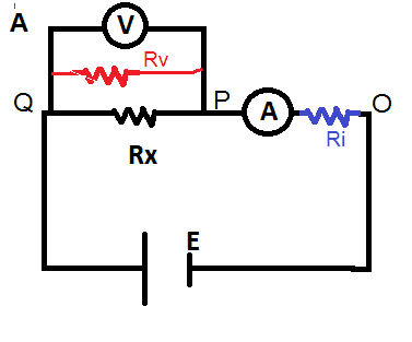

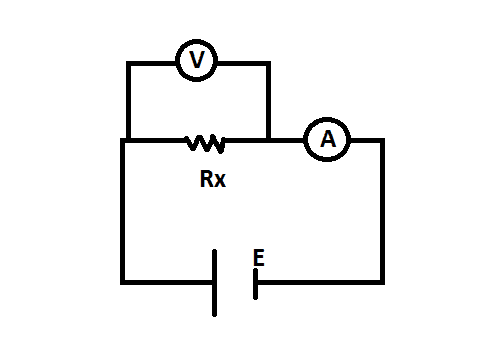

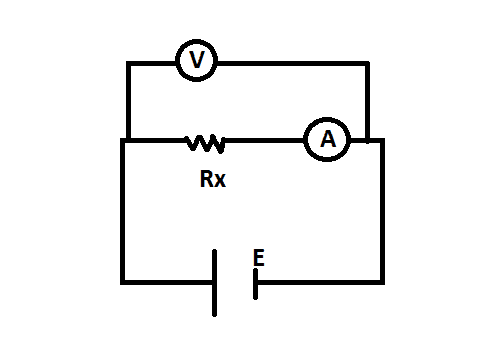

Calculate the internal resistance of V & A based on methods A & B below:
Method A
Voltmeter = 1.46 V
Ammeter = 0.24 A
E (emf of battery) = 1.48 V
Method B
Voltmeter = 1.48 V
Ammeter = 0.24 A
Ohm's Law: V = I*R

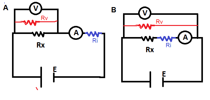

For method A, the current of the ammeter (II) splits into Iv (current of voltmeter) and IRX (current of unknown resistor). Also there will be an unknown resistance of voltmeter (RV) and an unknown resistance of ammeter (RI).
I found a relationship using Kirchhoff's current law:
II = IV + IRX
Then, I tried to use Kirchhoff's voltage law through both loops, but I'm ending up with too many unknowns. Am I going on the right path?
Also, I'm not sure if I could find the unknown Rx by just using Ohm's Law:
Method A:
Rx = V / I
Rx = 1.46 V / 0.24 A = 6.08 Ω
Method B:
Rx = V / I
Rx = 1.48 V / 0.24 A = 6.17 Ω

No, your simple method is not correct. You have to calculate with the internal resistances, Rv and Ri. Include them into the drawings, Rv parallel with the voltmeter and Ri in series with the ammeter.
From method 1, would that mean that I can find an equivalent resistance from Rv and Rx using the parallel circuit formula?
Also, from method 2, I could find an equivalent resistance from Ri and Rx using the series circuit formula?
I'm still not sure how that would help me in solving the problem.
Yes.
In case A, the voltage difference E-Uv falls on the internal resistance of the ammeter. You know also the current flowing through Ri, so you can calculate it. In case B, you know the voltage across Rx+Rv, and you also know the current. Apply Ohm's Law to get Rx+Ri. But you know Ri already...

Adriano25 said:
I'm sorry, I don't follow you. Could you please reexplain it? Thank you.
What is that you do not understand?
Look at the figure A. The meters are replaced by ideal ones, together with the internal resistances. The EMF of the (ideal) battery is 1.48 V, and the voltmeter reads 1.46 V. What is the potential difference between P and O?
The potential difference between P and O would be V = Ii * Ri
Yes, and what is the numerical value?
But we don't know Ri.
I was thinking that since Rx and Rv are in parallel, they share the same voltage, so V1 = 1.46.
Then, using Kirchhoff's voltage law:
-V1 * Ii - Ri * Ii + E = 0
so, Ri = 4.7 Ω ?
so, Ri = 4.7 Ω ?
V1*Ii is not voltage, you can not add it to voltages.
Ups..
-Rx*Ii - Ri * Ii + E = 0
Ri = 0.04 Ω
Adriano25 said:
Ups..
Ri = 0.04 Ω
No. Rx and Ri are not in series, they have different currents.
You know the KVL. The voltages add in a loop. The voltage between Q and P is shown by the voltmeter, it is 1.46 V. The voltage between Q and O is the same as the emf of the battery. What is the numerical value of the voltage between P and O?
Then it would just be the difference between QO and QP, so the voltage between P and O would be 0.02 V?
YES!
