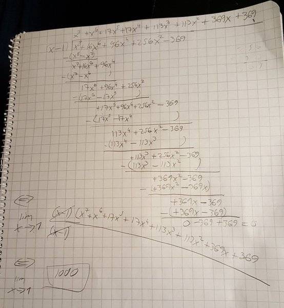

putting that into polynomial long division in the Anglo-American format of the long division.
After some time, the remainder comes out at zero (which is good) because it implies our original expression was indeed factorable.
pic of polynomial long division. I attempted to follow the instruction in the Finnish language wiki article as best as I could. Anglo_american long division is indeed taught as the only long division in most schools I reckon...
The quotient is ##(x^7+x^6+17x^5+17x^4+113x^3+113x^2+369x+369)##
and remainder =0
Hence we can continue and cancel the expression with (x-1) out of there##\lim_{x\to 1}\frac{[x-1](x^7+x^6+17x^5+17x^4+113x^3+113x^2+369x+369)}{x-1}##
##\lim_{x\to 1}{(x^7+x^6+17x^5+17x^4+113x^3+113x^2+369x+369)}##
plug in x=1 and we will have the limit = 1000, as x->1
Well, the result seems to be correct. But why haven't you defined ##g(x)=(x^2+4)^4## instead? If you write the limit with ##g(x)## instead of ##f(x)##, does it look familiar to you?
