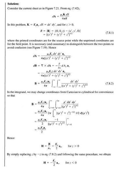

As you know we can find the flux density (B) via vector potential with this equation
So with this equation and solution at first i try to find vector potential completely then use above equation
Problem:
Solution:
my approach:
now we use curl A to find B
we find that
but it is different form the book soltuion
what is my problem and wrong?
Thanks

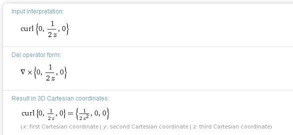

as i want to solve the new integral
Cvec%7Bay%7Ddxdy%7D%7B%5Cpi%20%28x%5E2+y%5E2+z%5E2%29%5E%7B%5Cfrac%7B1%7D%7B2%7D%7D%7D.gif
a new problem appears
for example if i want to calculate the inner integral the integral going to be infinite.
%7B%5Cfrac%7B1%7D%7B2%7D%7D%7D%3Dln%28+%5Cinfty%20%29-ln%28%5Csqrt%7By%5E2+z%5E2%7D%29.gif
Ln(infinite)=infinite
now how can solve this problem?
Thanks
