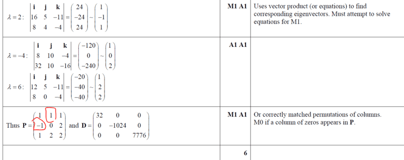

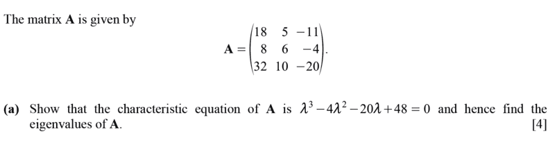

see attached - refer to part b only (part a was easy)
matrices
For part (b) i was able to use equations to determine the eigenvectors;
For example for ##λ =6##
##12x +5y -11z=0##
##8x-4z=0##
##32x+10y-26z=0## to give me the eigen vector,
##\begin{pmatrix}
1 \\
2 \\
\end{pmatrix}## and so on.
My question is to get matrix P does the arrangement of the eigenvector matrices matter?
In my arrangement for eigenvectors for ##λ=6,-4,2##
i have,
##P=\begin{pmatrix}
1 & 1& 1 \\
2 & 0 & -1 \\
2 & 2 & 1
\end{pmatrix}##
and my Diagonal matrix is
##D=\begin{pmatrix}
6^5 & 0 & 0 \\
0 & -4^5 & 0 \\
0 & 0 & 2^5
\end{pmatrix}=
\begin{pmatrix}
7776 & 0 & 0 \\
0 & -1024 & 0 \\
0 & 0 & 32
\end{pmatrix}
No, but where you place the eigenvectors (i.e., in which columns) will determine P, which will determine ##P^{-1}## which will then determine where the eigenvalues appear on the diagonal matrix D.
