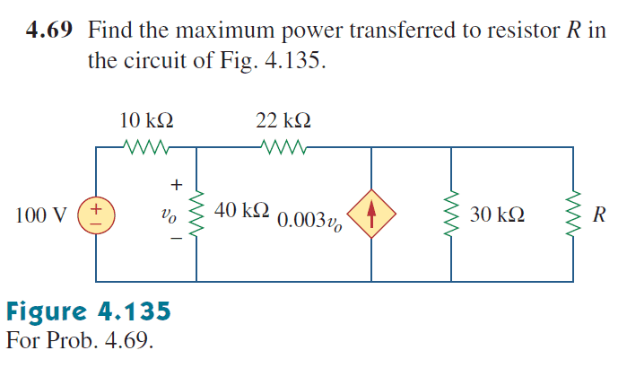

Find Maximum Power to Resistor R
In summary: You need to find the voltage at the output with the load attached as well. Then calculate the power delivered to the load. It will be finite. The maximum power delivered will be when the load resistance is equal to the Thevenin resistance. That is where the "infinity" comes in.Yeah, you're right. I think I just had a brain fart. Thanks for the help.In summary, the conversation discusses finding the Thevenin equivalent circuit for a given problem. The equations Pmax = ((VTh)2)/(4RTh) and Rparallel = (R1R2)/(R1 + R2) are mentioned, as well as the principles of KCL and KVL. The

Okay, so to find RTh, I remove all independent sources and set the "terminals" at R to have a 1A current running through them. Since there is a 30kΩ resistor in parallel with the 1A current that I added, I assumed that the voltage across the 1A that I added was 30kV and that RTh = 30kV/1A = 30kΩ.
Then I returned to the initial circuit to find VTh. I applied nodal analysis such that v1 = v0 and v2 = VTh.
Applying KCL @ v1:
(v1 - 100)/10 + v1/40 + (v1 - v2)/22 = 0
Applying KCL @ v2:
(v1 - v2)/22 - .003v1 + v2/30 = 0
After simplifying and solving the system, I got v1 = 70.1V and v2 = 42.7V. Then I plugged v2 into the equation for pmax and I calculated .0152W. However, the solution in the back of the textbook says that the power should be infinity. What have I missed?

Why did you ignore the rest of the circuit? The dependent current source may well influence the Thevenin resistance (hint: It does!).
Stick on the 1A external current source and determine the voltage at the output with the rest of the circuit intact (including the 100 V source). Find your Rth from there by the ratio of I/V.

Your first node equation looks fine, but the second seems to be mixing incoming and outgoing current terms in the sum. Check it.

Okay, that was not the best advice on my part. You should suppress the independent sources when you drive the circuit with an external stimulation. Sorry about that. o:)

You need to be a bit careful when you write the resistance values in k Ohms in your equations. You are effectively dividing through the denominators by 1000, or equivalently, multiplying the whole equation by 1000. This will affect the sizes of current supplies too! So instead of a 1 amp source stimulating your circuit it's 1000 mA. And the dependent source needs to be multiplied by 1000 as well.
I think you'll find different results when you do that.

Okay, so if I remove the independent voltage source and send a 1mA current through the terminals such that v2/1mA = RTh, would these equations be correct?
KCL @ v1:
(v2 - v1)/22 - 3v1 + v2/30 - 1 = 0
KCL @ v2:
v1/10 + v1/40 + (v1 - v2)/22 = 0
Yes they should work.

Okay, so when I simplified and solved the above equations, I got v1 = 4.33E-4 and v2 = .0016, which means .0016V/1mA = 1.6Ω, I think. Then I adjusted my nodal analysis equations by removing the 1mA and returning the 100V, and these are the equations that I got:
KCL @ v2:
(v2 - v1)/22 - 3v1 + v2/30 = 0
KCL @ v1:
Simplifying and solving these, I got v1 = 125.7V and v2 = 251.4V.
When I square 251.4 and divide by 4RTh, I'm going to have a very large power, but it won't be infinite. What am I still missing?
I think you need to show step by step how you solved the previous two node equations and found Rth. Something's amiss.

For RTh:
KCL @ v1:
KCL @ v2:
For the first equation, I used 660 as a common denominator...
(30/30)((v2 - v1)/22) - ((30*22)/(30*22))3v1 + (22/22)(v2/30) - 1((30*22)/(30*22)) = 0
30v2 - 30v1 - 1980v1 + 22v2 = 660
-2010v1 + 52v2 = 660 ← Final Equation 1
For the second equation, I used 880 as my common denominator...
((4*22)/(4*22))(v1/10) + (22/22)(v1/40) + (40/40)((v1 - v2)/22) = 0
88v1 + 22v1 + 401 - 40v2 = 0
150v1 - 40v2 = 0 ← Final Equation 2
Then I put these final two equations into my calculator as matrices, this time getting v1 = -.364V and v2 = -1.363V.
To find VTh:
First, I adjusted Final Equation 1 by removing the term caused by the 1mA current:
-2010v1 + 52v2 = 0
Then I adjusted Final Equation 2 by adding a term for the 100V source:
150v1 - 40v2 = 8800
Then I put this into my calculator as matricies to get v1 = -6.3V and v2 = VTh = -243.6V
So you're pushing 1 mA into the circuit across a voltage of v2 = -1.363 V. What does that make Rth?
Your Vth looks good.

Doesn't that make RTh = -1.363kΩ?

Yes it does!

Okay so...
Pmax = VTh2/(4RTh)
P = (-243.6)2/(4*(-1363)) = -10.8W
Are you allowed to have negative power?
Negative power implies that the circuit is absorbing power from the load, which can happen. But there's more to it here.
Draw the circuit as a load resistor connected to your Thevenin equivalent model. You have a voltage divider consisting of the Thevenin resistance and the load resistor. The load resistor is a standard one with positive resistance. Can you find a value that might lead to "interesting" behavior?

If RL = -RTh, then when I apply KVL to the circuit you told me to draw...
VTh + RThi + RLi = 0
243.6 - 1363i + 1363i = 0
243.6 = 0
Which is wrong, which might have something to do with the power being infinity?

Indeed. Leave the load resistance as a variable R and write an expression for the power. Take a limit as R approaches Rth.

I think I'm confused or maybe using the wrong formula... regular power P = V2/R
P = VTh2/RL
lim RL → RTh VTh2/RL = constant, at least in this case where VTh and RTh are constants...
Or should I be using this formula:
P = ((VTh)/(RTh + RL))2RL
In which case, I can take the limit as RL → -RTh and get infinity.
The latter is closer. The voltage should be squared.
The first one ignores the Thevenin resistance which is in series with the load.
