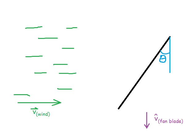

This isn't a homework problem, but i embarrassingly keep getting stuck on this simple problem..
Suppose my turbine's blades are flat surfaced.
the green lines represent the wind towards the black turbine blade at the right. the blade is drawn as an edge view, such that you'd be looking towards the center motor.
i've tilted my blade at some angle theta in reference to the plane perpendicular to the direction of the wind (as depicted by the blue angle). finally, the purple arrow is just to represent the direction that the turbine's blade will end up moving towards.

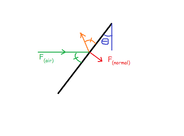

consider the next image
(Assumptions being made:
* Elastic collision
* Smooth surface (such that no tangential component of force is transferred to the surface) )
This is a force diagram as well as a path diagram just put into one.
Green & orange arrows: represent the incident and reflected path of a air particle (since no tangential force component transferred, angle of incidence (green angle) should equal angle of reflection (orange angle))
Red arrow:Transferred normal force component by collided particle.
$$F(norm)=F(air)cos\theta$$

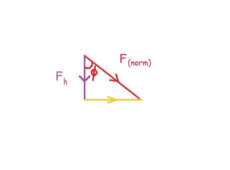

now breaking the F(norm) into its components WRT the blade's motion...
The purple vector F(horizontal), being the force comp. responsible for propelling the turbine blade.
to explicitly show what [itex]\phi[/itex] is:
the blade's surface is superimposed on the previous image with all the angles drawn
so then [itex]\phi[/itex]= 90-[itex]\theta[/itex]
$$F_{h}=F_{norm}cos(90-\theta)=F_{norm}sin\theta=F(air)cos\theta sin\theta$$

There are several problems with the way you're modelling it.
The blades usually have an aerofoil cross-section, and the motive force arises in the same way as wing lift.
Ignoring that, you have to consider the rate at which the blades are moving across the airstream. This changes the relative velocity of the air to the blade. This is why blades are more edge-on to the wind close to the rotor shaft. It also means that even after fixing the blade shape you can optimise the power output by adjusting the load (resistive torque).
Thirdly, if the air were bouncing elastically off the blade (which it doesn't - it flows over the blade) that would increase the normal force.
Apart from the unrealistic model, when I graph [itex] cos^2 \phi sin \phi [/itex] I get a maximum at +35.26 degrees and a minimum at -35.26 degrees. This is because if you angle the blades the other way, the force will be in the opposite direction.
The other maxima/minima are ithe same because the turbine doesn't change if you rotate the blades 180 degrees.
