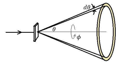

I don't understand why you integrated over ##\phi## the way you did.
The picture I have in mind is this
The total solid angle subtended by the yellow ring would be the integration of ##d \Omega = \sin
\theta d\theta d\phi## over ##\phi##.

Your solution makes no sense to me.
As @TSny writes, ##d\Omega## is the slice of the spherical surface in yellow in post #2. I.e., ##=2\pi\sin(\theta)d\theta##. No other integration is necessary.
Seems to me that the question cannot be solved numerically without a value for ##d\theta##, as @TSny pointed out in post #8 in the earlier thread.
