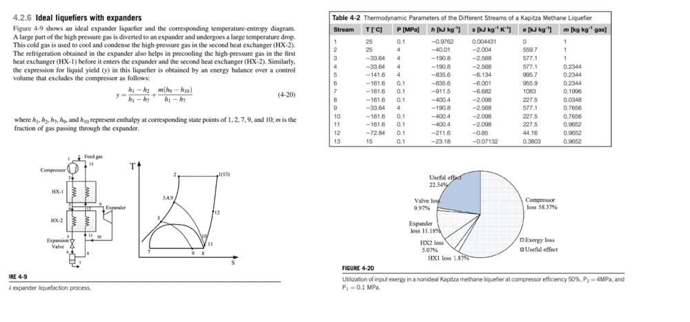

Reproduce the results in Figure 4.20 (shown in post). [Exergy loss in a liquefaction system].

Problem, with state values, and pie chart (Fig 4.20) showing answers:
^ This shows the system in question (Kapitza Liquefaction System). Methane gas enters into the compressor (c), then goes through the first heat exchanger (HX1). Some of it (z) gets routed to the expander (exp). Afterwards, the rest goes to the second heat exchanger (HX2), then to the Expansion Valve (JT). Then, the liquefied methane is collected (state 7), and the rest is routed back, first to HX2, then HX1, before going right back to the compressor, with a certain amount being supplied between state 13 and state 1.
Using Table 4-2, here are the results I obtained:

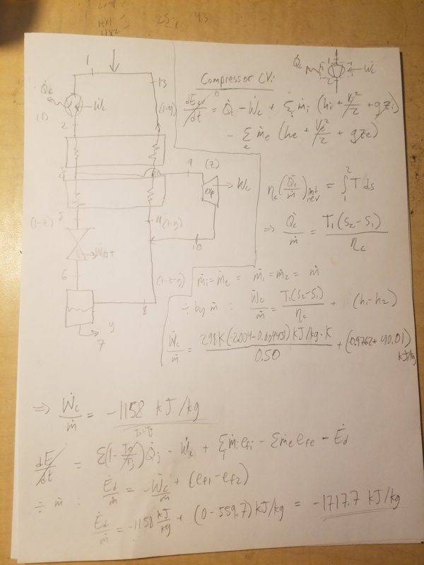

1) Compressor analysis: The book has calculated the compressor work as follows:
## -\dot{W}_c = \frac{1}{\eta_c}*(h_2-h_1)*\dot{m} ##
However, when I calculated the problem, I accounted for heat transfer, since there must be heat leaving the system when work is done. Using the second entropy equation given above, and pluging that into the energy balance (first equation above), I got:
## -\dot{W}_c = \frac{1}{\eta_c}*(h_2-h_1)*\dot{m}+\frac{1}{\eta_c}*(T_1)*(s_1-s_2)*\dot{m} ##
Is there no heat transfer from the compressor? Why?

yaro99 said:
Additional question:
Easier if we keep numbering and call this 3) to avoid confusion.
Compressor does work to
If the compressor is reasonably insulated, not much heat loss occurs. Thermodynamically the heat you mention leaves with the outgoing fluid. This is accounted for in the enthalpy flow. An ideal (reversible) compression step is isentropic and yields a ##\displaystyle {W_{isentropic} = \Delta h_{is} = h_{is}-h_{in} }##. A real one has ##\displaystyle {\eta_c \equiv {h_{is} - h_{in} \over h_{out}- h_{in} } \ }## with ##\eta_c<1##, so ## h_{out} > h_{is}## . In other words: more work an a higher enthalpy at the same pressure, in still other words: more heat going out with the fluid.

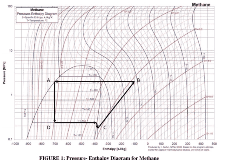

Actually, from the pressure-enthalpy diagram for methane (below), it appears that stream 5 is a compressed liquid. When this liquid is flashed in the expansion valve, a small amount flashes to vapor (14.8%), and the remainder stays liquid. The result is also a lower temperature (-161.6 vs -141.6) as a result of the heat of vaporization.

Further comments ( I seem to like this exercise)
  • What's labeled 'Compressor' in Fig. 4-9 is a compressor with a cooler to bring the temperature back to 25 ##^\circ##C. No matter, the exergy analysis is over a control volume that 'excludes the compressor' ? But Fig. 4-20 includes the compressor !
  • Table 4-2 should show that stream 11 is the sum of 8 and 10, so 0.8004 kg/kg, not 0.9652. That influences the heat exchange ('cold recovery') considerably !
  • The source is Handbook of Liquefied Natural Gas, Saeid Mokhatab et al. I can't see how they reference enthalpy. When I reconstruct the flowsheet (with the stream 11 error) in the freeware Coco flowsheeting program from Amsterchem, the exergies come out fairly OK.
