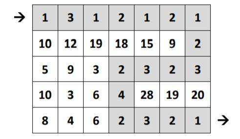

I am looking the following:
The board of a game is an $M \times N$ board with squares, where the starting point is on left - in position $(0, 0)$ - and the finish is in the lower right - in position $(M-1, N-1)$. Each square contains a positive number that describes the cost of moving to pass through this specific square. Design and analyze an algorithm that finds the path to minimum cost from start to finish considering that we can move up, down, right or left. For example, in the table below the minimum cost is 35 and is given by the designed path.
For this problem I have the following idea:
We convert this table into a graph, specifically a weighted graph with weights the cost of each square. In this way the problem will be to find the shortest path of the graph, right? :unsure:
That graph that we get is not directed, is it? :unsure:

Yep. That will work. (Nod)
Suppose we move from square (0,0) to (0,1), what will be the weight that we assign to this path?
And what is the weight if we move from (0,1) to (0,0)? 🤔
Isn't it equal to $1+3=4$ ? :unsure:
Isn't it $3=1=4$ ? :unsure:
Isn't it $3=1=4$ ?
Doesn't that mean that if we follow (0,0) -> (0,1) -> (0,0) that we get a weight of (1+3)+(3+1)=8?
That is, aren't we counting the 3 twice when we should only count it once?
What I mean, is that I believe we need a directed graph, which is actually what you implemented in your algorithm. 🤔
Suppose we are at the point $(i,j)$ then the possible moves are up, left , right, down, i.e to go to $(i-1,j)$, $(i,j-1), (i,j+1), (i+1, j)$, right?
Now we have created the graph, right? Is that correct so far?
Shouldn't we consider that not every edge is possible since some of the destinations are "off the board"? 🤔
Btw, don't forget to keep track of the starting and ending vertices in G. 🧐
Now we far to call an algorithm that calculates a shortest path. Do we apply Dijkstra because we have only positive weights and we are looking for a path between two specific vertices?
Yep. (Nod)

mathmari said:
I haven't really understood how it follows that the graph has to be directed. Could you explain that further to me?
Consider the board
$$\to\begin{array}{|c|c|c|}\hline 1 & 2 & 3 \\ \hline\end{array}\to$$
The corresponding graph could be:
right? 🤔
Also note that it has special nodes for start and finish that we need for Dijkstra's algorithm.
Ahh sowe have to consider some restrictions if the point is on the edges, right?
Yes. We should for instance only add the edge from $(i,j)$ to $(i-1,j)$ if $i>0$. 🤔

mathmari said:
Do you mean that if we has an undirected graph we could go back to "start" ?
No. (Shake)
The weights as given in the table are for the nodes themselves, and counted when we pass through them.
But for Dijkstra's algorithm we need a graph that assigns weights to the edges instead of the nodes.
In my suggested graph we've solved that problem by assigning the weight of the node we enter to an edge.
It does mean that the reverse edge has a different weight.
And it also means we have to introduce an artificial start node so we can introduce an edge with the weight of the first node. 🤔
So do we have the following?
Then do we just call the algorithm "Dijkstra" ? Or do we have to do also something else?
Yes.
And indeed, the only left is to call Dijkstra's algorithm with the graph, the source, and the target. (Nod)
Strictly speaking, we should strip an artificial start node again though (assuming we added one).
Or alternatively, we could choose not to add a start node at all, but instead add the weight of the first node to the result afterwards. 🤔

Each node has at most 4 edges, so $|E|=O(4MN)$.
The printing part iterates through each of the nodes on the shortest path.
In a worst case scenario that means we have to iterate through $O(MN)$ nodes. 🤔
So is the total complexity as follows?
Let $c$ be the constant complexity of "G.AddVertex" and $d$ the constant complexity of "G.AddEdge".
\begin{align*}T&=c+ \sum_{i=0}^{M-1}\sum_{j=0}^{N-1}c+d+\sum_{i=0}^{M-1}\sum_{j=0}^{N-1}d+T_{\text{Dijkstra}}+T_{\text{print}} \\ & =c+ \sum_{i=0}^{M-1}\sum_{j=0}^{N-1}c+d+\sum_{i=0}^{M-1}\sum_{j=0}^{N-1}d+O((MN+4MN)\log(MN))+O(MN)
\\ &=c+cMN+d+dMN+O((MN)\log(MN))+O(MN)\\ & =O((MN)\log(MN))\end{align*} Is the analysis correct and complete? :unsure:
mathmari said:
So to get the correct order with this code, do we add the vectors in an array and print them at the end?
That would work yes. (Nod)
You did mean nodes instead of vectors didn't you?
Yep. (Nod)
