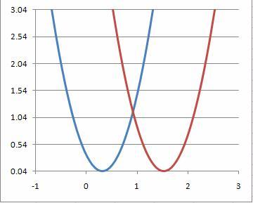

In other words, how do I minimize:
(x0+y0-2)2
(2x0+y0-3)2
(-4x0+y0+6)2

You are using the 2nd approach I mentioned which involves only two variables. OK, you have a function of two variables that you want to minimize. Using an analogy of a single variable function, what do you know about the derivative at the minimum? Same concept applies to multi-variable problems only you use partial derivatives (thus two equations in the case of two variables). Result should be two equations in x0 and y0 that can be solved by substitution. Pure algebraic solution. You are almost there.

I got (1.04,2.55). I'm going to try to check it.
uh.. hmm. how can I check it? I tried against plots of the lines using an array of arbitrary x's. It doesn't seem right.
i did something wrong. chain rule still applies to partial derivatives right?

There are a couple of practical ways to check. One is to verify that the expressions for the partial derivatives are indeed zero using the values of x0 and y0. The other way is to calculate the sum of distances and see if the sum increases or decreases with small changes in both directions of x0 and y0. That's basically a way to numerically determine the partials are zero. Better yet, plot sum of square distances as a function of x0 and y0 keeping each one constant while varying the other. You should see a nice parabolic looking plot in each case.

Sweet, I found a mistake in my calculation. I have something to go of of.
This time I got (1.517,0.317). It is still wrong, though, graphically the y-coordinate looks correct. I am stuck :S

That's within 1% of the answers I got. I got 0.042 for sum-of-square-distances. If you plot sum-of-square-distances separately against x0 and y0 you should get a plot like this:
too bad, that means I did it right, but my minimization function that I told you/have been using must be wrong. Oh well.
thank you so much for all your time and help, it helped a ton.
wait, so its correct? why is it not correct to take say, a bunch of random x's and plot the lines with those x's then look for where the obvious closest spot then plot the point and see if it looks right?
It must be correct. I understand your checking and plot and it says that the answer is correct. now I just don't understand why my method of checking was erroneous.
