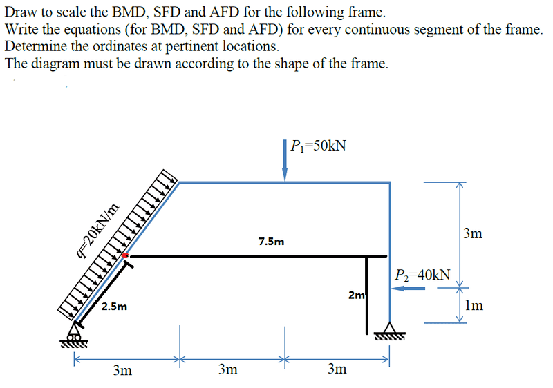

Find reactions at supports and bending/shear/axial diagrams
In summary: Remember, the frame as a whole remains static, so the individual members must be static as well. Thanks for your reply! Before I proceed, I want to make sure something.In my calculation for the left body, I resolve vertical reaction into two components. One is used to find out the shear force and one is the axial force along the beam.Is my concept here correct? If this is the case, how do I balance Rh here?

Force by uniform loading = 20(5) = 100kN
Vertical component of the uniform loading = 20(5)(3/5) = 60kN
Horizontal component of the loading = 20(5)(4/5) = 80kN
vertical reaction at roller support = Vr
vertical reaction at pin support = Vp
Fx=0, Fy=0, M=0
Finding reactions[/B]
Horizontal reaction is only at pin support. Let it be Hp. As Fx=0
Hp=80-40=40kN (to the left)
So I take moment at pin support first so as to find out Vr
Vr=[40(1)+50(3)+60(7.5)-80(2)] / 9 = 160/3 kN (upwards)
take moment at roller support to find Vp
Vp=[100(2.5)+50(6)-40(1)] / 9 = 170/3 kN (upwards)
Attempt to find out the equations for diagrams

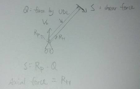

for the left part of the frame (free body)
Resolving Vr into two component
let the one perpendicular to frame be Rp, Rp = 32 kN
the other one along the frame be Ra, Ra = 128/3 kN
distance from roller be x
Axial force = Ra = 128/3 kN
Shear force = 32-20x,
M=32x-10x2
But for the middle part and right part of the frame, how do I consider the free body? and the segments divided by the point loading?
I tried thinking to cut at the top-right corner to consider the right part of the frame as a free body but then what should I do for the segment between the P2 loading and the corner?
The middle part is even more messy to me.
Thanks!

You've calculated the reactions on the sloped member in a coordinate system which is aligned with that member. What you need to find is how these forces are transmitted into the other member(s)of this frame. IOW, you need to find the components of the forces which are aligned with the other member attached to the sloped member.
