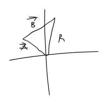

A car travels 20 mi at 60 degrees north of west, then 35 mi at 45 degrees north of east.
Express each displacement vector in unit vector notation. Take the +x-axis due east and the +y-axis due north. Use the component method to obtain the resultant displacement vector in unit vector notation.
[tex]\ A = \ A_x i + \ A_y j[/tex]
[tex]\ B = \ B_x i + \ B_y j[/tex]
[tex]\ C = \ C_x i + \ C_y j[/tex]
A= -20sin60i+35cos60j
B=35cos45i+20sin45
C=?
How do I find C, since no lengths were given. Did I do A and B correctly?

The solutions look incorrect so far. For A, both the x and y components involve the 20 mile displacement, and for B, both the x and y components involve the 35 mile displacement. Also, can you show a sketch that shows how you determine when to use the cos() and when to use the sin() to find the components on the x & y axes?
Finally, you are indeed given the lengths of 20 and 35 miles, so you will be able to calculate the sum vector C = A + B. :smile:

I do not know to convert to rectangular component form. I think we are suppose to put it in unit vector notation.

berkeman said:
No. I mentioned what was wrong in my first reply.
And for converting between polar and rectangular formats of vectors, use this type of figure:
http://www.teacherschoice.com.au/maths_library/coordinates/polar_7.gif
Okay I redid everything and found:
A=20cos60i+20sin60j
B=35cos45i+35sin45j
C=(-20cos60+35cos45)i+(20sin60+35sin45)j
Did I do all the trig stuff right? I am suppose to find the magnitude too which I found was 97.62.

jeff12 said:
A=20cos60i+20sin60j
I believe there is a sign error in this equation... :smile:

jeff12 said:
But I want to make sure, C is the resultant right? Because C is technically R.
The problem statement doesn't specify. It was you who chose ##\mathrm{\vec{A}}## to represent one of the two given vectors and ##\mathrm{\vec{B}}## the other. Likewise you are free to choose ##\mathrm{\vec{C}}## or ##\mathrm{\vec{R}}## as their sum.
No, you are not supposed to find the magnitude. You are supposed to express the result in unit vector notation.
berkeman said:
Could you show your work for the final answer for C? Thanks, that will help us answer...
There was no C. I figured that out. I was confused because in his example he kept saying R=A+B+C. But since I was only given two vectors it would be R=A+B. I found R=14.75i+42.07j. The magnitude is 44.58 mi at [itex]70.68^o[/itex].
