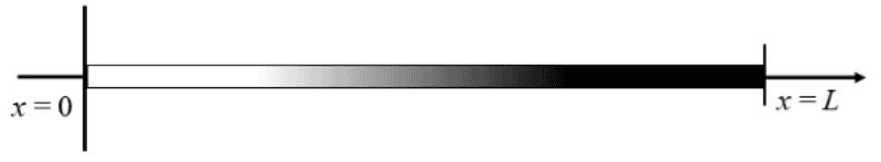

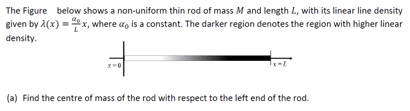

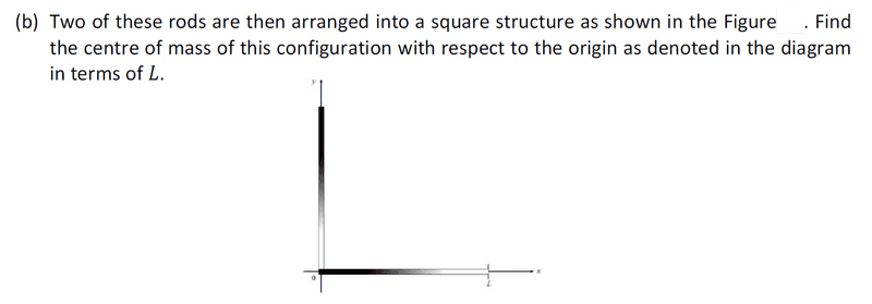

(a)
$$\bar x=\frac{\int_{0}^{L} \frac{\alpha_o}{L}x^2dx}{\int_{0}^{L}\frac{\alpha_o}{L}xdx}$$
$$=\frac{2}{3}L$$
(b)
$$x=\frac{x_1+x_2}{2}=\frac{1}{6}L$$
$$y=\frac{y_1+y_2}{2}=\frac{1}{3}L$$

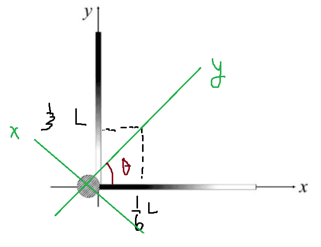

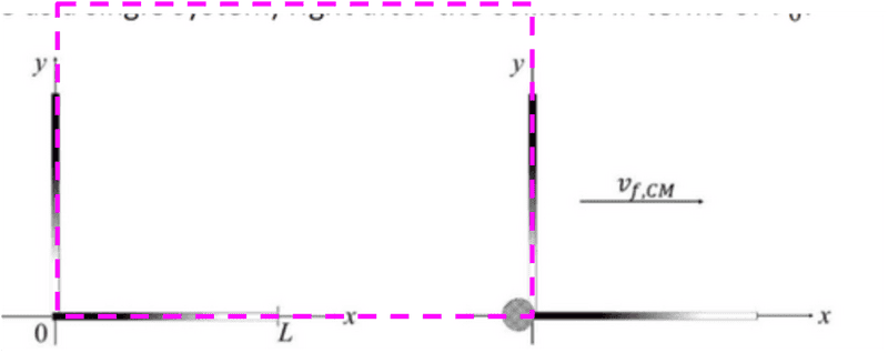

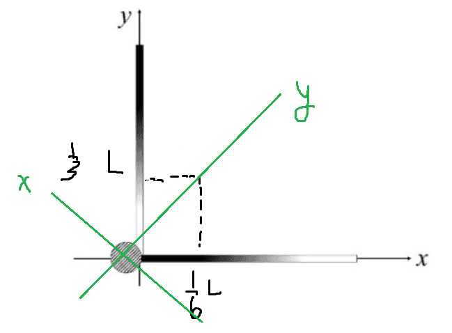

(c) I am not sure about this part. Do I need to divide the conservation of momentum into two directions?
In x-direction:
$$M.v_o\sin\theta=3M.v_{f,CM}x$$
$$v_{f,CM}x=\frac{2\sqrt{5}}{15}v_o$$
In y-direction:
$$M.v_o\cos\theta=3M.v_{f,CM}y$$
$$v_{f,CM}y=\frac{\sqrt{5}}{15}v_o$$
So:
$$v_{f,CM}=\sqrt{(v_{f,CM}x)^2+(v_{f,CM}y)^2}$$
$$=\frac{1}{3}v_o$$
Is that correct?
Thanks

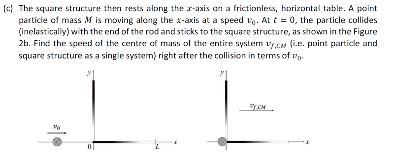

Conservation of what kind of momentum in two directions?
The linear momentum of the CM of the system consisting of the two rod structure plus the particle is initially only in the x-direction. Momentum conservation means that it is the same after the collision, i.e. still only in the x-direction.
There is another kind of momentum that is conserved through the collision. What kind might that be? Hint: It's in a direction perpendicular to the xy-plane.
Likes songoku

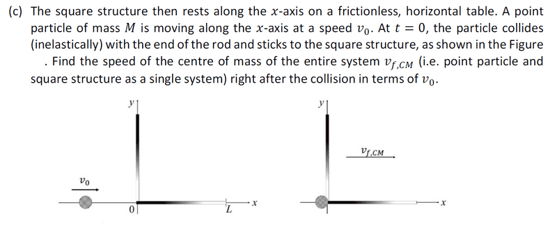

Except that there will be a vertical impulse from the table.
Likes songoku
Why is there vertical impulse from the table?
I read the problem to mean that the plane of the L-shaped structure is parallel to the (frictionless) table. I interpreted the figure to be a top view of the structure resting on the table. The statement "The square structure then rests along the x-axis on a frictionless, horizontal table" says nothing about the y-direction being along the vertical.

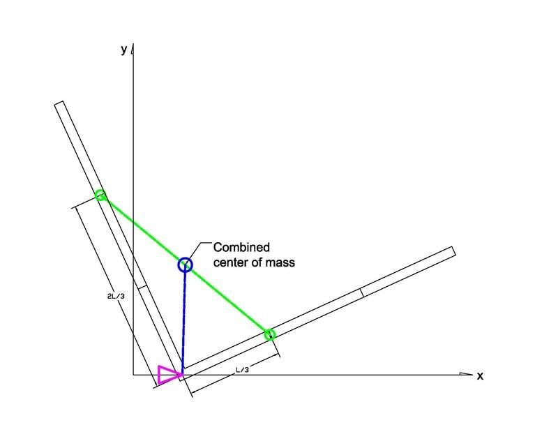

I think the particle will rotate about the center of mass of the whole system.
I already have the CM of the L-rod, which is ##\left(\frac{1}{6}L, \frac{1}{3}L\right)##. Adding the particle of mass ##M## will change the CM of the system to ##\left(\frac{1}{18}L, \frac{1}{9}L\right)##
The final CM is supposed to be the axis of rotation
You are probably right. I read "rests along the x axis" as meaning it only rests on that. Otherwise, why not say it rests along the x and y axes?
Also, if it is lying flat on the table, doesn’t question c become trivial (and @songoku's answer correct, but done very much the hard way)?
Likes songoku
I just realized I got the same answer by doing simple calculation:
$$M.V_o=3M.v_{f,CM}$$
$$v_{f,CM}=\frac{1}{3}v_o$$

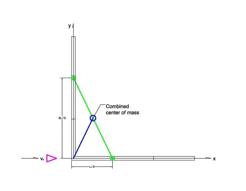

My first thought was I need to consider the collision where the CM of particle and CM of L-rod are in one line, that's why I divide the working in two directions but apparently it is not needed. So conservation of momentum can be applied even though the CM of two objects are not in a straight line?
And if let say the case is the plane of L-rod is perpendicular to the table, why is there vertical impulse from the table?
I imagine the L-rod will still rotate counterclockwise due to the force exerted by the particle during collision. Is the rotation causing the vertical impulse?
But the movement direction of the colliding mass is not in line with the CM of the pre-collision L-shaped rod.
Because of the above, the non-elastic collision should induce simultaneous rotation and translation of the newly formed three-mass system respect to the flat horizontal frictionless surface.
It doesn't have to be. Since there is no external torque on the L-shaped structure + particle system, the angular momentum about any point is conserved. In this problem, one would choose the CM of the system as the reference for angular momentum because this simplifies the conservation equation to $$Mv_0~d=I\omega$$ where ##~d=~##distance of the CM to the x-axis; ##I=~##moment of inertia of the composite object after the collision about its CM. In this form, there is only orbital angular momentum before the collision and only spin angular momentum after the collision. OP's choice was to start with zero angular momentum effectively moving the orbital part from the left hand side to the right hand side.

The mass centre will have an X component and a Y component of velocity.
I would represent the motion just after impact as a velocity of the particle and an angular velocity. Since the particle still has no rotation around (0,0) we can leave that out and just consider the angular momentum of the rods about (0,0). It might be simpler to calculate for each rod separately and sum them.
You also still have conservation of linear momentum in the X direction.

I am sorry for really late reply.
Conservation of linear momentum in the x-direction can be used to find the x-component of ##v_{f,CM}## which would be ##\frac{1}{3}v_0##
I try to separate the L-rod into horizontal and vertical part. For the horizontal part of the L-rod and considering conservation of angular momentum at origin, the total angular momentum before collision between the particle and horizontal rod is zero. I am not sure about the total angular momentum after collision.
There would be spin angular momentum ##I_{rod}~\omega## but what about the orbital angular momentum?
Thanks

Here’s what looks to me to be the simplest approach…
Forget about the velocity you found for the mass centre of the system. It is not helpful.
Let the velocity after impact of the ball (and rod joint) be ##u##, and the angular velocity of the rods be ##\omega##.
For the linear momentum after impact, you have the horizontal velocities of the ball and horizontal rod as ##u##. What is the horizontal velocity of the mass centre of the vertical rod? What equation does conservation give you?
For the angular momentum about the (static) point of impact, you have:
  • 0 for the ball
  • angular momentum of the horizontal rod about the point of impact due to ##\omega##. There is no angular momentum due to its linear motion. What is its moment of inertia about that axis?
  • angular momentum of the vertical rod about the point of impact
For angular momentum of the vertical rod about the point of impact consider its motion as the sum of the linear motion of its lower end (##u##) and its rotation (##\omega##).
What is its moment of inertia about that axis? What is its angular momentum due to
  • its linear motion?
  • its rotation?
  • #35
