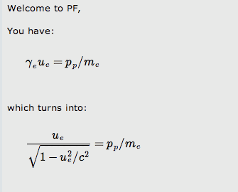

Welcome to PF,
You have:
[tex] \gamma_e u_e = p_p / m_e [/tex]
which turns into:
[tex]\frac{u_e}{\sqrt{1-u_e^2/c^2}} = p_p /m_e [/tex]
You need to solve for u_e. I would say that it would help to get rid of the square root by squaring both sides of the equation. It would also help to get rid of the fraction by multiplying both sides by the denominator of the left-hand side (after you've squared). Then you have some terms that contain u_e and some that don't. Collect all the terms that contain u_e in order to isolate it. EDIT: and to avoid clutter, don't plug in numbers until the very end.

Okay, we normally don't do people's homework for them, but since you've given it a solid attempt and shown your work, and indicated which parts you're having trouble with, I think the forum rules have been satisfied. By the way, did the LaTeX (fancy math) equations from my last post show up for you? I'm asking because physicsforums recently changed what software it uses to generate equations from LaTeX code, and it hasn't been working for some people. A screenshot of my previous post is attached just in case. Anyway, here are the algebraic steps that I would take:
