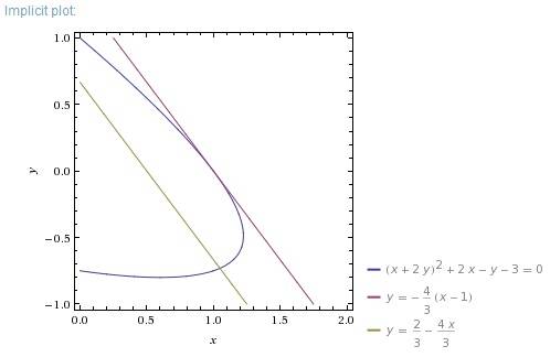

Here is a plot of the given curve, line and the tangent line:
Here is a link to the program I used to plot them:
(x+2y)^2+2x-y-3=0,y=(4/3)(1-x),y=(2-4x)/3, where x=0 to 2,y=-1 to 1 - Wolfram|Alpha
