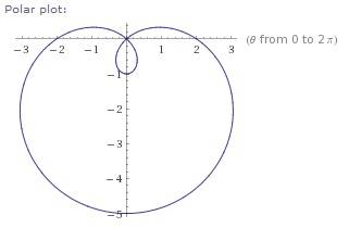

Here is the question:
How do I find the polar coordinates for the horizontal and vertical tangent lines?
For r=2-3sin(θ)
With decimal approximations to 4 places for the angles at which the tangent lines occur?
I keep messing up when I try to do this on my own, much appreciation to any who help

The first thing I would do is look at a polar plot of the given function:
Next, let's parametrize the curve:
\(\displaystyle x=r\cos(\theta)=\left(2-3\sin(\theta) \right)\cos(\theta)\)
\(\displaystyle y=r\sin(\theta)=\left(2-3\sin(\theta) \right)\sin(\theta)\)
Hence:
\(\displaystyle \frac{dx}{d\theta}=\left(2-3\sin(\theta) \right)\left(-\sin(\theta) \right)+\left(-3\cos(\theta) \right)\cos(\theta)=6\sin^2(\theta)-2\sin(\theta)-3\)
Equating this to zero, and applying the quadratic formula, we find:
\(\displaystyle \theta=\sin^{-1}\left(\frac{1\pm\sqrt{19}}{6} \right)\)
Because $\sin(\pi-\theta)=\sin(\theta)$, we also have:
\(\displaystyle \theta=\pi-\sin^{-1}\left(\frac{1\pm\sqrt{19}}{6} \right)\)
We may add integral multiples of $2\pi$ as needed to place $0\le\theta<2\pi$.
So, rounded to four places, the angles at which the tangent lines are vertical are:
\(\displaystyle \theta\approx1.1043,\,2.0373,\,3.7358,\,5.689\)
\(\displaystyle \frac{dy}{d\theta}=\left(2-3\sin(\theta) \right)\left(\cos(\theta) \right)+\left(-3\cos(\theta) \right)\sin(\theta)=2\cos(\theta)\left(1-3\sin(\theta) \right)\)
Equating each factor in turn to zero, we find:
\(\displaystyle \cos(\theta)=0\)
\(\displaystyle \theta=\frac{\pi}{2},\,\frac{3\pi}{2}\)
\(\displaystyle 1-3\sin(\theta)=0\)
\(\displaystyle \theta=\sin^{-1}\left(\frac{1}{3} \right),\,\pi-\sin^{-1}\left(\frac{1}{3} \right)\)
So, rounded to four places, the angles at which the tangent lines are horizontal are:
\(\displaystyle \theta\approx0.3398,\,1.5708,\,2.8016,\,4.7124\)
