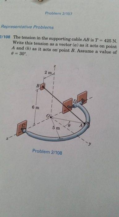

1. Homework Statement
The tension in the supporting cable AB is T = 425 N. Write this tension as a vector (a) as it acts on point A and (b) as it acts on point B. Assume θ = 30°. [***I've attached a picture of the exact problem]
The answer in my textbook says TA = <221, -212, 294>
TB = <-221, 212, -294>
T [/B]= (T)(n)
n
= (AB) / (||AB||)
I started by finding the AB which I used A = (0, 5cos(30), 5sin(30)) and B = (2, 0, 6), which gave me AB = <2, -4.33, 3.5>.
Next I used n = (AB) / (||AB||) to find n = <.338, -.732, .5916>
Then I found T = (T)(n) = <143.65, -311.1, 251.43>I'm not sure what I'm doing wrong here. The only thing I can think of is if I'm using incorrect points for point A
It looks like θ is in the x-y (azimuthal) plane, so it should not apply directly to the z-coordinate as one did for the coordinates of A, necessarily.
One needs to think in terms of two angles, poloidal and azimuthal. Note point B is offset from the polar axis.
Thank you! I'm pretty sure fixed my problem. I absolutely hate when the textbook doesn't make it obvious which plane the angle is in.
So that changed my A to A = (-2.5, 4.33, 0), which changed my tension to the correct answer.
