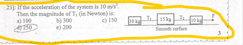

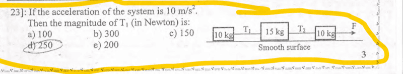

As picture
sum of F=ma
This is the problem and my answer below it.
my friends said it's 250 N and I say it's 100 N based on what I solved what am I missing ??

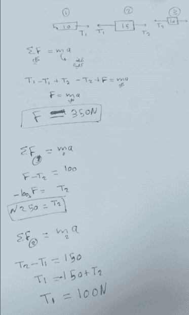

my try:
Note: In my picture the weird word is in Arabic and it means **Total**.
@Azim
I did analysis that and I still get same result!
what am I missing?

Ask these questions to yourself:
1) How are the force ##F## and the tension ##T_1## related? (Hint: Consider the relation between ##F## and ##T_2## and then ## T_2## and ##T_1##)
2) Of the two masses involved with ##T_1## which of them is "pulling" and thus what should be the ##F=ma## analysis on that mass?
I think I made a mistake in reading your question, I thought you were the one who answered 250N. Going back over it, I think you're right, and your friends are wrong!

Your answer is correct.
Although there is a more direct way to get the answer, your analysis is fine.

What is the Free Body Diagram on the last block and what is the only Force acting on it? What must be the value of the Force acting on it such that it moves at 10 ## m/s^2##?

In a system, If the bodies are rigidly connected to each other, we can consider the system as one composite body. As a result, the acceleration of the bodies in this system is the same.
Another way to find ##T_1##:
Just use Newton's second law for the body that has 10 kg mass.
The net force on the 10 kg body is ##T_1##(since there is no friction force).
##T_1=m_1a_{system}=10*10=100N##
##m_1a_{system}## is the net force that acts on the body.
