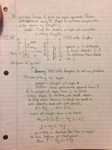

A constant force F pulls a rope vertically upward. The rope is lifting a block of mass M, to which it is attached. The rope is of uniform composition, and has mass m and length L. Find the tension in the rope at a position y along its length. (The tension will not be uniform in the rope.)
kinetic force, Newtons second law
attached file. I am not sure what it means by "Find the tension in the rope at a position y". I drew a FBD, and attempted to solve for the tension on the rope.
As it says, the tension is not the same all along the rope. You are to find the tension at distance y from one end of the rope. Unfortunately it is not made clear which end. I would take it as from the bottom of the rope.
okay I think so too.
how would I go about finding the tension at a point y? I am not sure how to add that into the equations.

Draw a free body diagram for the portion of rope below y. What forces act on it?

This is what I worked out. I drew the FBD and found that the force F (tension) and weight of the rope from point y to the block.
I hope this is correct, but I am not sure.

Two things...
Not sure why you switched from y to L-l. Aren't they the same? I would avoid using lowercase l for a variable since it can be confused with I in some fonts.
More importantly, you have assumed there is no acceleration.

that's the part that was confusing to me - I am not sure what to do because of the acceleration. I was just assuming the velocity is constant, so that the tension = weight force - because the second law tells us the net force would be 0. Also, y is just the point where as L-l is the distance. I guess it should be L-y.
I am not sure what to do if the velocity is not constant.

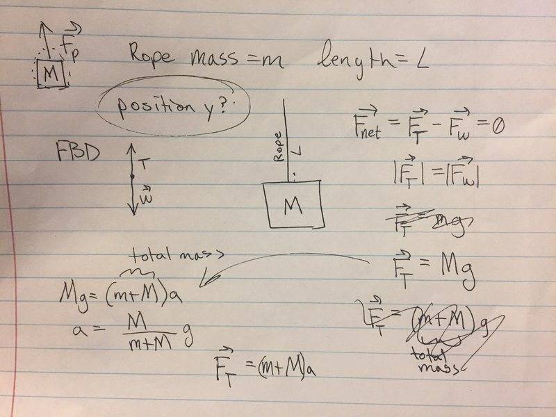

Consider the whole rope and mass as a system. What forces act on it? What acceleration results?
Incorporate that into your force balance for the mass-plus-length-y subsystem.

I just saw this part so that would just change the L-y to y correct?
I just did that, I thought about it and came up with this result. I thought the Fnet of the system would have to include the total mass times acceleration. Then used that in the other equation I had from before.
I hope this is right because I really thought this through and I always hope that my thinking is correct. That is what is most important to me, is that I can think the problem through in the correct way - it really helped me through calculus.
Thank you for the guidance!

Yes, Fnet=a(M+m), but you made a bit of a blunder getting to the next line.

I mean that your expression for a is wrong. It is not (M+m)/Fnet. That is not even dimensionally correct.
