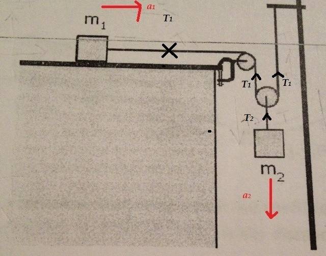

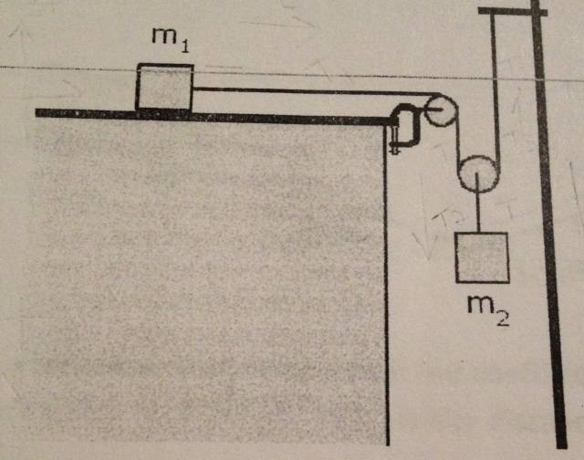

In terms of m1,m2, and g. find the acceleration of the hanging block in the two-block/ two-pulley setup shown in the diagram. The stands holding the string rests on the floor. All pulleys are massless, and there is no friction anywhere in the system.
F=ma
First I drew free body diagrams of both blocks and of the lower pulley. I numbered the tensions in the pictures. The equations that I got for m1:
Fy= N=mg
Fx= T1=m1a
For m2 I got:
Fy= T2-m2g=-a*m2
For pulley I got:
T1+T3=T2
Then I substituted T2 Into the equation for m2 and I got:
T1+T3-m2g=-a*m2
m1*a+T3-m2g=-a*m2
Now I am confused but I decided to call T3 just T because T is same in the rope.
As a result my answer is a= (m2g-T)/(m2+m1), but it is probably wrong. Could you please check if I am on track here?
Thanks for the help!
It is sort of hard to tell if you are on the right track (imo) because the picture you posted is basically impossible to read
Also ignore what it says on the picture it is not part of the question.
Edit: nvm, I can't read XD
No, all it says "the lab stand holding the string at the upper right rests on the floor. Thanks for help I appreciate it.

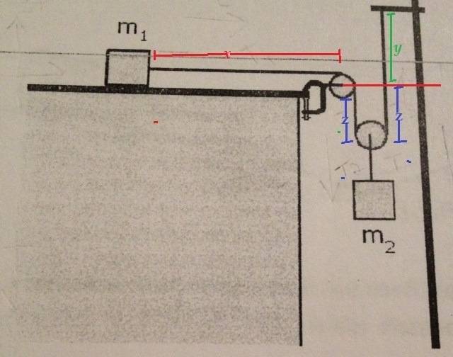

Hi Emily. Did you take into consideration their different accelerations? Determine their ratio this way― if m1 slides 1cm to the right, m2 will drop by what distance?
BTW, the pic in your first post is perfectly fine on my Android.
Would it be 1 cm too?
Do you have half a metre of string and a wheel or small bottle that can take the place of the pully? Arrange something over the edge of your table and you can try it and see!
m1 can be a heavy book or something.

Here are my new equations for the FBD:
For the first block (m1):
Fx T=m1a
For the second block (m2):
Fy T-m2g=-m2a
For the pulley:
2T-T-m2g=0 Not sure for this one if m2 is right and not sure that ma=0
And for the pulley its for Fy cause no Fx

I thought you may not be au fait with pulleys, that's why I'm encouraging you to construct something similar to the arrangement you are analysing, so that you discover something new here. Anchor one end of the string to a nail in the wall, and tie the other end to a book lying on your table. Hang the string over the edge of the table, and hold a small round bottle or just a pencil in the loop of the hanging string so it serves the purpose of the lower pulley hanging in the rope. When you make the book slide 10cm along the tabletop towards the edge, how many cm does this cause the lower "pulley" sink?
  • #32
Fx 1T=m1a1
Fy 2T-m2g=-m2a2
For the pulley:
1T+1T-2T=0
Is it right now?
  • #33
Emily_20 said:
Fx 1T=m1a1
Fy 2T-m2g=-m2a2
For the pulley:
1T+1T-2T=0
Is it right now?
Your two equations are right but your last eq. is not correct.
There two many 'T's floating around. And also there are two tension as there are two strings.
I think this figure will make you clear
Now can you find relation between ##T_{1}## and ##T_{2}##?
