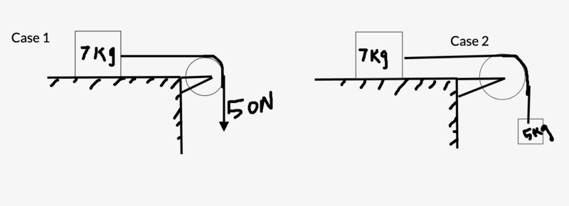

A 7kg block rests initially on a table in case 1 and case 2 above. The coefficient of friction between the block and the table is 0.2. The block is attached by a cord of negligible mass which hangs over a frictionless pulley. In case 1 a force of 50N is exerted on the pulley and in case 2, a 5kg mass is hung. Calculate the acceleration of the system in case 1 and in case 2.
F = ma
In both the cases 7 kg mass accelerates towards the right because of the 50N force. The unbalanced forces in both the cases are the force of gravity due to 5kg block and force of friction. Applying Newton's second law of motion to cases 1 and 2 yields the following results for acceleration:
Where m1=5kg, m2 = 7kg, g=10m/s2
Case 1,
a = Net force/ total mass
a = m1g - friction force/(m1+m2)
= m1g - friction force/ (m1+m2)
= 50 - (0.2x7x10)/12 = 3m/s2
Case2,
In both the cases acceleration came out to be the same. But the textbook gives a different answer where Case 1 acceleration is greater than Case 2. Does that mean in Case 1 the surface is taken as frictionless?

What is the force of tension from the hanging weight when the system is accelerating at ##a##?
Present the following:
Case 1- FBD od 7 kg block.
Case 2 - FBD of 7 kg Block and 5 kg Block for case 2.

What is m2 doing in your equations for case 1 ? :nb)
In case 1 what does m1g represent? There is only one mass and that the 7 kg mass on the table. It is pulled by a constant force of 50 N. What is Newton;s second law in this case?

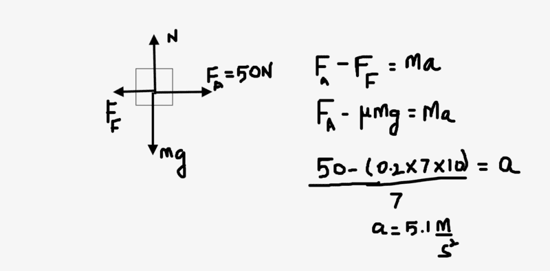

What is Newtons Second law for the mass ##M## in the ## x \rightarrow^+ ##
Please, take a minute and try to format the equations using latex. It is not difficult to learn.

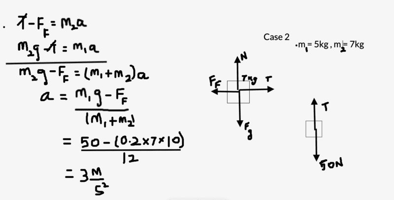

That's better. What about case 2?
That's good. Congratulations, you've done it. Now please consider learning how to use LaTeX.
For future reference its always better to just state your directional conventions so we don't have to reverse engineer it from the equations you provide.
