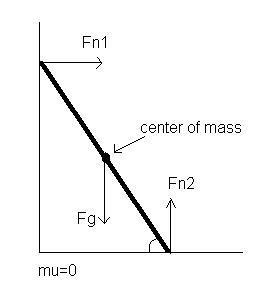

A uniform ladder of length L leans against a smooth (no friction) wall. The floor is also smooth (no friction) and the ladder makes an angle of Theta-0 with the floor when the ladder is installed at rest.
a) Before the ladder leaves the wall, express the equations of motion of the ladder in terms of a single generalized coordinate.
b) Find a constant of the motion.
c) Find the angel theta at which the ladder leaves the wall.

OK... this is what I have so far:
Free body diagram: What are the relationships between the normal forces and the gravity?
Motion of center of mass: this works... but we now need to find the acceleration along this path and such... hmmm

Well, this is a classic problem.
As I recall, the sly way to do this is to use energy.
Your pictures don't make sense. How can the center of mass move in the fashion demonstrated?
I sort of derived why the equation of motion is x^2 + y^2 = 1/4 L^2.
That's the equation of a circle, if you didn't know. Again though, this is only if the ladder stays against the wall, which, in theory, it wouldn't.
As for understanding the motion, though, you can see it pretty easily:
Take a piece of paper, draw the wall and floor. Then draw many of the same-length ladder in different positions against the wall. Completely upright, completely laying down, and many positions in between. Then draw a dot at the middle of each ladder and connect the dots :)
First off, your center of mass particle draws out a complete quarter circle, which isn't possible considering its motion is not along the entire ladder (from wlal to floor). Second, you have drawn the CM moving to the right and then concave downward, but the force pulling the ladder is directed downwards. It should be starting down and then concave right as the ladder bottom is pulled out.
