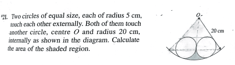

Find the Area of the shaded region in the given problem

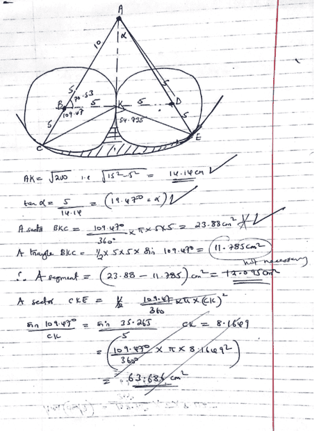

See attached
Circular measure
Wawawawawa boggled me a little bit... but finally managed it...seeking alternative approach guys;
kindly note that what i have indicated as ##*## and a ##√## is the correct working ...
Text book answer indicates ##17.5## as answer... will re check my rounding solutions later...
My working- allow me to copy paste here...will later type the working...
From your sketch, say S is area we want, it seems
2S=\frac{1}{2}*20^2 (4\alpha)-4*\frac{1}{2}*15\cos \alpha*5-2*\frac{1}{2}*5^2(\pi+2\alpha)
where
\sin\alpha =\frac{1}{3}
Is it same as your idea ?
Likes neilparker62, chwala and Steve4Physics
