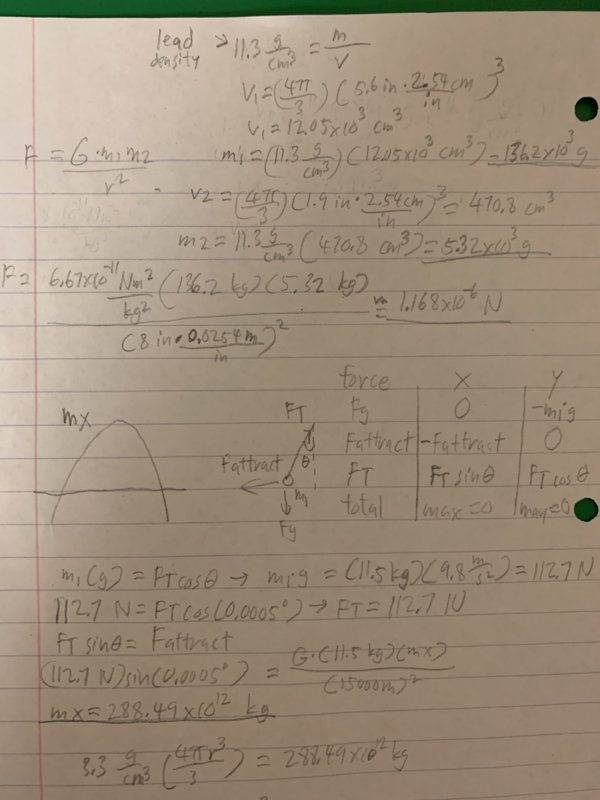

total radius=((5.6in)+(1.9in)+(0.5in))(0.0254m) = 0.203m
(mass1)(9.8m/s^2)=(6.67 * 10 ^(-11) ) (mass1)(mass2)/( (5.6in)(0.0254 m) )^2
mass2=2.97 * 10^(9) kg
(mass2)(9.8m/s^2)=(6.67 * 10 ^(-11) ) (mass1)(mass2)/( (1.9in)(0.0254 m) )^2
mass1=342.2 * 10^(6) kg
F=(6.67 * 10 ^(-11) )(342.2 * 10^(6)) (2.97 * 10^(9)) / (0.203m)^2
F=1.645 * 10^(9) N
Apparently this incorrect. I don't know why.
The problem is your determination of m1 and m2. Why are you using 9.8 m/sec^2? Show us your work in determining these masses.

The density of lead does not appear in your calculations anywhere. You appear to be determining the mass of the balls by assuming that the acceleration of each ball toward the other is 9.8 m/sec^2. That is not correct. You have the mass of a lead ball of radius 1.9 inches at 342 million kilograms!

This the correct force=1.18 * 10^(-6) N ?
You should show us how you arrived at that answer.
AM
The top portion is for this question
Your method is correct. If you use 11.34 g/cc for the density of lead the answer should work out to 1.18 e-6 N.
