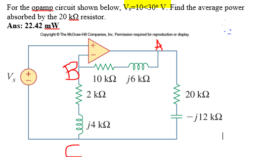

Find the Average Power absorbed by the 20k Resistor

I wrote the following equations using node voltage, my issue is that I'm confused about why the RC branch at the output doesn't effect the value of the Gain for the amplifier; the equation involving VA / ( 20k - j12k ) is omitted in the solution.
IAC = IAB + IBC
V- = V+ = VB = VS
( VA-VC )/(20k -j12k) = ( VA - Vs )/(10k + j6k) + (Vs-Vc)/(2k+j4k)
Vc = Vground = 0V
(VA)/(20k-j12k) = (VA-Vs)/(10k + j6k) + (Vs-Vc)/(2k+j4k)
If the opamp is ideal, which apparently it is, its output impedance is zero--it's an ideal voltage source so any impedance connected from the output (VA) to ground has no effect on the rest of the circuit.
Did you solve your equations and did they give the right answer?
Likes DaveE

Nope. Try again.
KVL says that voltages added in a complete loop must sum to zero.
KCL says that currents flowing into a circuit node must sum to zero.
If I was solving this problem, I would just name all of those branch impedances, like ZBC = 2KΩ + j4KΩ, etc. Then I would solve the problem in terms those named impedances. So, for example, the current through ZBC would be Vs/ZBC, etc. I wouldn't actually calculate any complex arithmetic until I had the answer expressed in an equation with those named impedances. It doesn't have to be done this way, of course, but it's a style that I think is easier, particularly if you have to find and fix mistakes.

Okay, I'm not sure which direction the currents actually move here.
IAB - IAC = IBC
My equations are incorrect, so am I wrong in interpreting Zout as 20k - j12k?
The op-amp has infinite input impedance, so no current flows into it's inputs. Therefore, the current through the 10K resistor HAS TO flow through the 2K resistor too.
You have both defined and questioned the definition of Zout in a single sentence, that doesn't make sense. Sure you can name 20k - j12k as Zout.
ah okay, so:
IBC = IAB
VBC/(j4k + 2k) = VAB/(10k + j6k)
Where ZBC = j4k + 2k and ZAB = 10k+ j6k

Yes, work from that. You will want to know what the op-amp output voltage is to determine what the 20K resistor power is.

i'm still confused about what happens to the current when it reaches node A
Is VAB/ZAB = VAC/ZAC?

The op-amp can source or sink current in order to make it's input voltages equal, because it has negative feedback. That is how op-amps work.

nevermind, I think I got it. The purpose of an amplifier is to establish a larger voltage at the output (VA in this case so VA > VB meaning current is driven from node A to node B and through to node C and also from node A to node C through the RC path. it doesn't travel through that feedback (AB) path from node B to A. sorry if this is confusing
