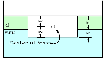

A small square plank of oak floats in a beaker half full of water. The piece of oak is 7 cm on a side and 3 cm thick and floats on its side as shown in Figure P10.80.
Density of oak 750kg/m^3
Density of water 1000kg/m^3
There were two parts to the problem, the first is:
Find the location of the center of mass of the plank with respect to the water’s surface. Someone else gave me the equation, so I was able to get this part, but I can't find the equation myself anywhere.

Second part (I need help here) is: A very light vegetable oil is poured slowly into the beaker, so that the oil floats on the water without mixing and until the oak plank is a few centimeters below the surface of the oil. If the density of the oil is 640 kg/m3, calculate the new position of the center of mass of the plank with respect to the water’s surface.

Since the density of oil is less than that of oak the block will want to sink (completely) in oil. That is, the buoyancy provided by the oil alone is not enough to support the block. Thus it will still sink somewhat into the water, too.
Consider the case where the oil is carefully poured until the level of the oil just reaches the height of the block as it floats in the water. The block's top surface will be level with the oil surface at some distance h1 from the water surface (so h1 is the depth of the oil) and the blocks bottom surface will a distance h2 below the water level. Note that the thickness of the block, w, is the sum of h1 and h2.
Using your expression P = P0 + d*g*h, can you write an expression for the pressure at bottom of the block? You can ignore the P0 due to the atmospheric pressure, since it presses down equally on everything and will cancel out in the balanced equations. Initially you can write the expression in terms of h1, h2, and the densities.

Angie_Agnes said:
P=ρgh -> P=1000*9.8*h2
You're forgetting the weight of the oil on top of the water...
Start with the pressure at the bottom of the oil layer (at the oil-water interface). That'll be your Po for the descent into the water layer.
P=640*9.8*h1+1000*9.8*h2
h1=.03-h2
P=640*9.8*(.03-h2)+1000*9.8*h2
P=188.16-16072h2=P

I think you might have miscalculated the h2 coefficient when you wrote your last line. Check your expansion.
Once that's fixed, solve for h2 in terms of P. What must P be in order to support the block?

Very close! But P is a pressure, not a weight. What pressure is required to support the block?
HINT: The block's weight is distributed over its bottom surface area.
ahhh yes, makes sense- P=F/A so... P=mg/a
P=1.08045/(.07^2) = 220.5
so applying that to the equation: h2=(220.5-188.16)/3528=.009167m
That looks good! So now you've got h2, the depth of the block's bottom below the water surface. Can you now find the location of the block's center of mass in relation to the water surface?
is it just h2*.5? .0045835m
Look at the geometry. The center of mass of the block is a fixed distance from its top and bottom.
.03-h2=h1 = .020833m
-> .03/2= .015m
.020833-.015=.005833m ??
Yup. Now all you need to do is express the result in cm and use a suitable number of significant digits. :smile:
