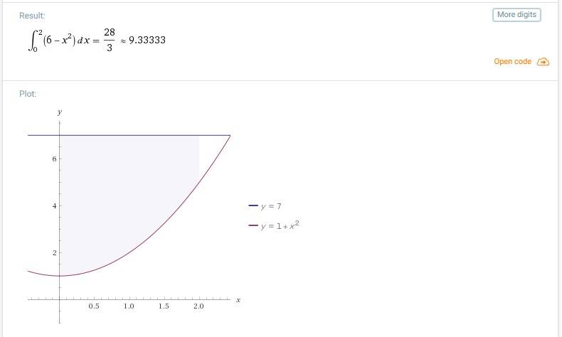

Oh, I see know, I was calculating the area underneath the curve, so I need to write ##7-x^2-1## instead to calculate the are between the line ##y=7## and the curve.
I think the integrals would be like this, am I correct?

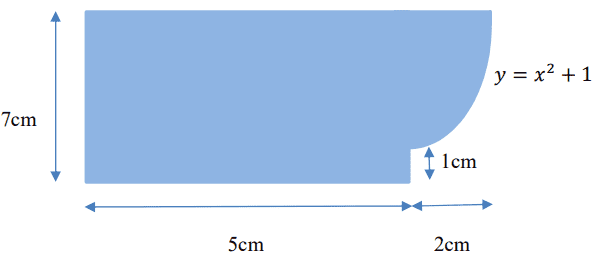

Davidllerenav said:
I think I know the problem. Do you see that I got a different value in the total mass integral? The problem is in the parabola, since I got 35 for the rectangle for both ##X_{cm}## and ##Y_{cm}##. The problem is that the equatio of the parabola ##y=x^2+1## isn't complete with ##x\in[0,2]##.
Ha! The problem is that the given diagram is wrong! At x=2, x2+1 is only 5, not 7.
My guess is that the distances 5 and 7 are swapped over. The plate should be 5cm high and 7+2cm wide. That fits better with the way it is drawn.
