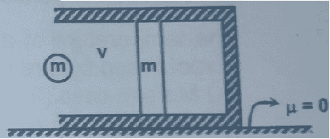

Initially, the piston will get a velocity ##v##.
But the chamber will move too because of the forces exerted by the gas.
Since total external force is zero, velocity of centre of mass is constant.
Initial velocity of centre of mass: $$\frac{mv+4m\times 0}{m+4m}=\frac{v}{5}$$

Two remarks (I haven't got a clue about the solution :frown:):
Cylinder plus piston are ##5m## as I read it.
Particle collides elastically - so it bounces back. Cylinder gets momentum and there is no friction, so in the final state it still is moving

Titan97 said:
with respect to earth, final velocity of both piston and chamber will be zero. (right?)
$$\frac{1}{2}m{v}^2=nC_{\mathrm{V}}\Delta T$$
I got the wanted solution by calculating the velocity of the piston after the elastic collision, taking into account only the mass of the piston for the first contact - then you can calculate the velocity of piston, chamber and gas (index pcg) at the point of maximal compression (at the point, when piston and chamber proceed with the same speed).
The final velocity of piston, chamber and gas won't be zero with respect to the ground. You have to take into account the kinetic energy of piston, chamber and gas (index pcg) in your formula.
$$\frac{1}{2}m{v}^2=nC_{\mathrm{V}}\Delta T+\frac{1}{2}m_{pcg}{v_{pcg}}^2$$
