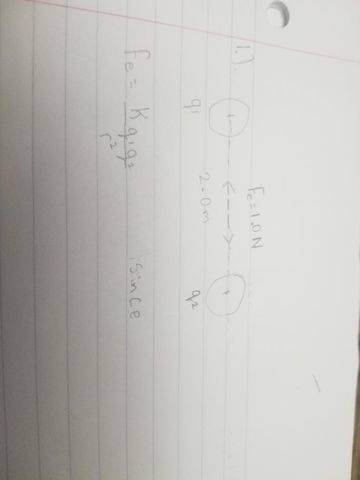

Two small spheres (q1& q2) have different charges that add up to 5.0x10^-5 C. If they repel each other with a force of Fe = 1.0 N at a distance of 2.0 m apart, what is the charge on q2?
Electric force formula
Fe= (k*q1*q2)/r^2
Electric Field Formula
E=(k*q1)/r^2
where k is a constant 9x10^9 N*m^2/kg^2
I drew a diagram using all of the information
however, I am stuck and not to sure how to get one of the charges
Try writing out the equation that says the charges add up to…
See if that gives you enough info.
