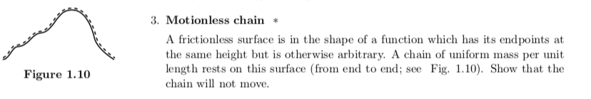

I only need help with how to find the component of gravity along the curve.
Here is the problem statement:
A frictionless surface is in the shape of a function which has its endpoints at the same height but is otherwise arbitrary. A chain of uniform mass per unit length rests on this surface (from end to end; see Fig. 1.10). Show that the chain will not move.
None.
I only need help with how to find the component of gravity along the curve. See image.

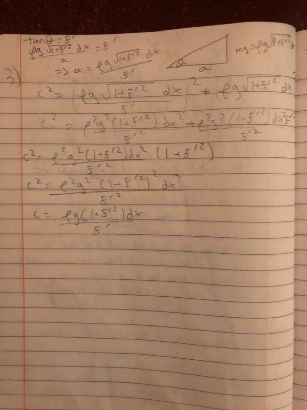

Please see attached, c is the component of gravity along the curve (hypotenuse). Have I done anything wrong?
I do not understand where some of your equations come from. It doesn't help that the order on the page doesn’t seem to match the order of your reasoning.
Please stop posting images of your working, it is against forum rules.
Take the trouble to type it in, in logical order. Then I will be able to make reference to specific steps more easily.

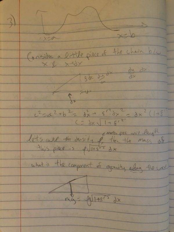

My apology, let's start from the beginning.
Consider an infinitesimal piece of the chain between x and x+dx. The opposite side is given by f'dx.
The hypotenuse of the chain can be found by Pythagorean's theorem.
$$ c^2 = dx^2 + f'^2 dx^2 = dx^2 (1+f'^2)$$
Then ##c = dx \sqrt{1+f'^2}##
Let's call the density (mass per unit length) of the chain ##\rho##, then the mass of this piece is given by ##\rho \sqrt{1+f'^2}##
The question is, what is the component of gravity along the curve?
First, the force of gravity gravity is given by ## mg = \rho g \sqrt{1+f'^2} dx ##. In a right triangle, that would be the opposite side.
We also know that ## tan \theta = f' ##, using that the tangent of an angle is opposite over adjacent, we get
$$ f' = \rho g \frac{\sqrt{1+f'^2} dx}{a}$$
Where a is the adjacent portion of the triangle representing the horizontal component of gravity.
Solving for the adjacent side, we get ## a = \rho g \frac{ \sqrt{1+f'^2}dx }{f'} ##
Then, in order to find the hypotenuse (the component of gravity along the chain, I use Pythagorean's theorem:
$$c^2 =a^2 + b^2$$
$$c^2 = (\rho g \frac{\sqrt{1+f'^2} dx }{f'})^2 + (\rho g \sqrt{1+f'^2} dx )^2$$
Then, getting the common denominator:
$$c^2 = \rho^2 g^2 \frac{1+f'^2 dx^2 }{f'^2} + \rho^2 g^2 \frac{(1+f'^2) dx^2 f'^2}{f'^2}$$
Then factoring out some terms
$$c^2 = \rho^2 g^2 \frac{1+f'^2 dx^2 }{f'^2} (1+f'^2)$$
Simplifying..
$$c^2 = \rho^2 g^2 \frac{(1+f'^2)^2 dx^2 }{f'^2} $$
Then square rooting we get:
$$c = \rho g \frac{(1+f'^2) dx }{f'} $$
Which is the portion of gravity in the direction of the curve of the chain.
Electrowonder said:
we get
Gravity does not have a horizontal component, the normal force does.
To avoid getting tangled up with the normal force, write the force balance equation parallel to the slope.
