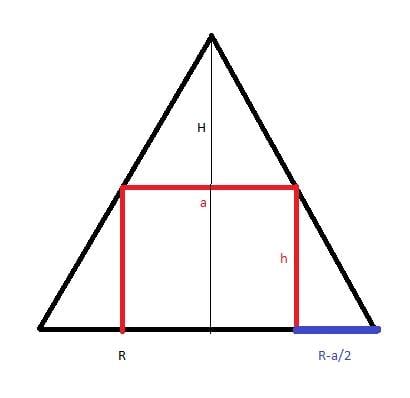

Find the minimum value of the volume of a cone that is transcribing a four-sided prism with a=42cm and h=8cm
[itex]V=\frac{r^{2}H\pi}{3}[/itex]
[itex]
\frac{H}{r}=\frac{h}{r-\frac{a}{2}}
[/itex]
From the equation above it follows that
[itex]H=\frac{2hr}{2r-a}[/itex]
Inserting this into V I get
[itex]V=\frac{2hr^{3}\pi}{6r-3a}[/itex]
Taking the derivative of this I get
[itex]\frac{dr}{dV}=\frac{2r^{2}\pi (4r-3a)}{(2r-a)^{2}}[/itex]
Setting this 0 and solving for r I get
[itex]r=\frac{3a}{4}[/itex]
Since a is 42cm I get 31.5cm as the answer
Setting this into the H equation I get:
[itex]H=3h[/itex]
Since h is 8cm, I get 24cm as the answer
Now, my solution textbook tells me that I got the answer for H right, but it tells me that r should be
[itex]r=\frac{63\sqrt{2}}{2}[/itex]
What did I get wrong? Where does the square root come from? :/

From this image I get that H must behave to R as h does to R-a/2

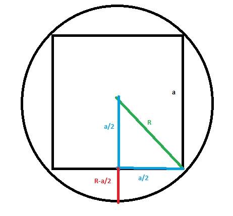

Ok, let's go with that interpretation. But your r-a/2 is wrong. Try drawing the view from above.
Oh now I see, the blue line should actually be
[itex]R-\frac{\sqrt{4R^{2}-a^{2}}}{2}[/itex]
Correct? :)
I rethought the problem and see now that
[itex]R=\frac{a\sqrt{2}}{2}[/itex]
Though I still don't see how that renders my
[itex]\frac{H}{R}=\frac{h}{R-\frac{a}{2}}[/itex]
invalid.
I still see the same ratio :/

Your new diagram is wrong in a different way. At the base of the cone, where the radius is R, can it touch the rectangular block anywhere?
At this point, I think the cross section in post #7 is correct and the work in the original post is correct. The radius comes out 63/2 and the answer key has an incorrect square root in the denominator.

I don't see how. It shows a width of a for the rectangular block. The cone must touch the upper corners of the block, and opposite pairs of those are distance a√2 apart.

Ahhh. You're right; that is a bit tricky to visualize. The block needs to be rotated ##45^\circ## about its vertical axis showing 3 vertical edges for the cross section to be correct.
Likes 1 person
In case anyone is still watching, here are a couple views (not to scale) of what this looks like. The first shows a front view looking directly at a face of the prism.
This is what the top view looks like for the same orientation.

The figure you posted pretty much corresponds to my figure in post #6, where I still fail to see why H/R = h/R-a/2 is incorrect
What would be the correct side condition?

No it doesn't. The top view in my post #14 looks like your figure in post #9.
Try to get that from the front view (first figure) in post #14. Your similar triangles aren't there.

Ahhhhhh now it makes sense.
What I calculated was basically for a pyramid, not a cone, wasn't it? :)

Take a vertical slice that passes through two diagonally opposite corners of the cube.
