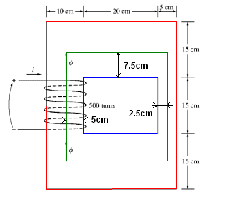

A ferromagnetic core is shown the figure below. The depth of the core is 5 cm. The other
dimensions of the core are as shown in the figure. Find the value of the current that will produce a flux of 0.003 Wb. With this current, what is the flux density at the top of the core? What is the flux density at the right side of the core? Assume that the relative permeability of the core is 1000.
R=l/μA
So I know to use this equation R=l/μA and I get what μ is and based on a similar problem in my book I also know what to do after I get Req. However what I am stuck on is how to get the mean path length l and the cross sectional areas A. I also know from the problem in the book I am supposed to separate it into different regions but how exactly do I do this?

You can find the mean length of the flux path very easy.
The red line represents the longest path which a flux line could take to go round the core. The blue line is the shortest path. Shown in green is the mean length of the flux path.
le = (l_red + l_blue)/2
l_red = 2*(10cm + 20cm + 5cm) +2*(15cm + 15cm + 15cm) = 160cm
l_blue = 2*20cm + 2*15cm = 70cm
So
le = (160cm + 70cm)/2 = 115cm

You don't want to compute mean path lengths. You want to compute the reluctance around the core.
You had the right formula for reluctance: R = l/μA.
So compute the sum of this formula for the four sections of the core: R = ∑ Ri = (1/μ)∑ li/Ai, i = 1 to 4.
Then apply mmf = Rø. ø = BA = flux and is constant around the core. mmf is magnetomotive force = NI. I is current.
ok so I get the length stuff now but I still don't understand how the areas are being produced I know for a rectangular space its length * width but whenever I do it the answer is wrong. I keep thinking the area for the top is 7.5*27.5=206.25 this is obviously wrong what am I doing. Should I be taking the coil dimensions?
I have l1= 55 cm and l2=l3=30 cm

The area for the top is 15cm x 5cm = 75 cm2. It's the cross-sectional area you're looking for.

The cross-section on the right leg is 5 x 5 = 25 cm^2.
The flux does not flow into or out of the page. It flows along the perimeter with depth = 5 cm everywhere.

ok so the left would be 10*5=50 because 10 cm is the diameter and 5 cm is the depth.
If I read what you put right it is 5*5 because it has a 5cm radius and 5 cm depth.
"Radius" and "diameter" refer to circular cross-sections. These cross-sections are rectangular.
The left cross-section is 10 x 5. The top & bottom are 15 x 5. The right is 5 x 5.
oh herp derp I got it now alright so back to the equation R1=l1/μA1=.55/((4pix10^-7)(1000)(.0075))=58.36, R2=l2/μA2=.30/((4pix10^-7)(1000)(.0025))=95.49, and R3=l3/μA3=.30/((4pix10^-7)(1000)(.0050))=47.74 the Req=R1+R2+R3= 58.36+95.49+47.74=201.59 then P=1/Req=1/201.59=.004960 then ø=FP so F=ø/P=.003/.004960=.604. F=Ni so .604=500i which gives I=1.2A then B=ø/A3=.003/.0075=0.4 T and B=ø/A1=.003/.0025=1.2 T
