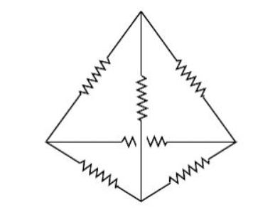

Six 100 ohm resistors are soldered together to form a regular tetrahedron. If the terminals of a 9V battery are wired to two of the vertices, how much current in A (amps) will flow from the battery?
V = IR
Yeah so I'm confused about this circuit because it has an overlapping path. My guess is that the current doesn't flow in one of the two paths in the middle but I don't have a good reason for it (I don't know why). I suppose there is symmetry but I haven't been able to find good videos on symmetry on YouTube. Can you help me solve the middle portion of this circuit? Much appreciated.

Where is the battery connected? What in the world does this mean for any connections?
Likes Jaccobtw
1) As berkeman pointed out, the problem statement is meaningless until you specify WHAT vertices get the 9V
2) I understand exactly what the 3D circuit looks like but you need to redraw it in 2D so it is more amenable to normal circuit analysis.

Not so hasty! Being a tetrahedron, it doesn't matter which two vertices you pick. (Any pair of vertices is related to any other pair by a rotation.)
To OP: once you've picked two vertices arbitrarily, can you use the symmetry to suggest i) which resistors have equal currents flowing through them and ii) which resistors have no current flowing through them? Follow-up: what's a simpler equivalent circuit?

Nuh-uh! it depends on where the dot goes in that middle bit! :wink:
Likes Jaccobtw
Mike, you are misreading the 3D circuit. I think it's quite clear. Or are you joshing us? Again. Still. You need to stop that dammit ; you confuse me ! Besides you name's Mike, not Josh.
Likes Jaccobtw and Tom.G
Well, I've never, ever seen a schematic with a fade to try to explain the connectivity. So you just stand down there young feller, util the OP can post a proper schematic diagram for us to help him on... :smile:
Likes Jaccobtw
A regular tetrahedron is a 3D figure. The fade is just because one resistor goes behind a front one.

Do you mean the dot that doesn't exist?
That style of wires crossing each other without connecting at least used to be somewhat common, and well understood.
And it sure cut down on the time in the drafting department!
Likes Jaccobtw
Either way, the statement that the resistors form the edges of a tetrahedron should be sufficient wthout the image.
As for the problem at hand, it should be quite clear that the circuit is a parallel coupling of a single resistor (the one on the edge between the connection points) and the rest. The ”rest” form a circuit that can be easily flattened and analysed.

Pick any vertex and look straight into it and what would you see?

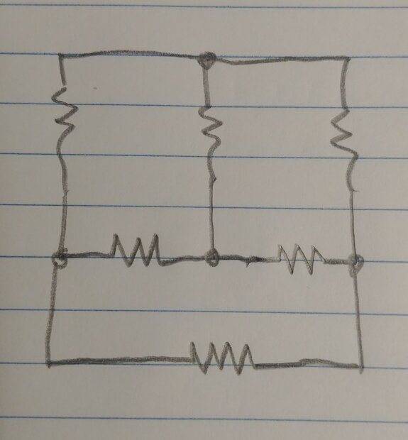

I think I figured it out. I connected the terminals to the left most and right most vertices, got rid of the middle vertical resistor due to symmetry, and the rest is just adding up the resistors in series and parallel.

If you get rid of a resistor even if it has no net current flowing, I think that changes the circuit.

Nope. If the current is zero, the voltage drop is zero, whether R=1Ω or 10MΩ. So you can change its value to ∞ provided you know that the current will always be zero. Same with branches that you know are 0V, those can be replaced with short circuits.

Also note that when they say the source can be connected across any branch, that means you can pick whichever one makes it easier to draw or visualize.
Anyway, this is a better schematic without the irrelevant geometry stuff.
