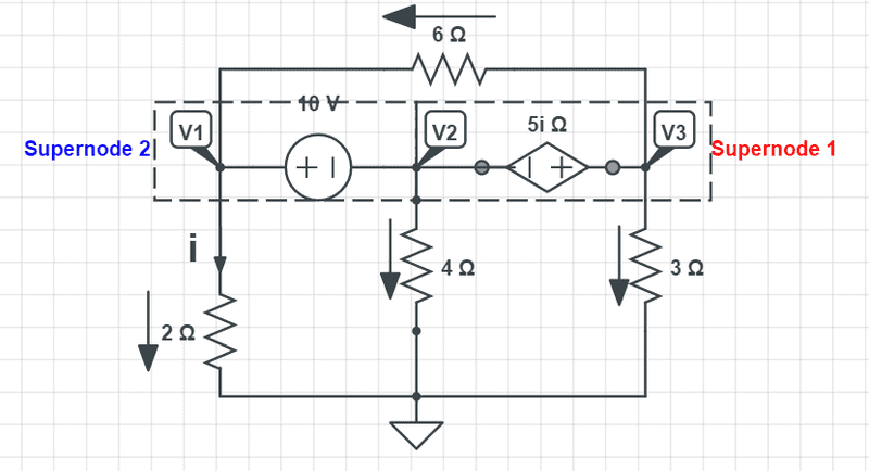

Find the current using Nodal Analysis

Find i using Nodal Analysis.

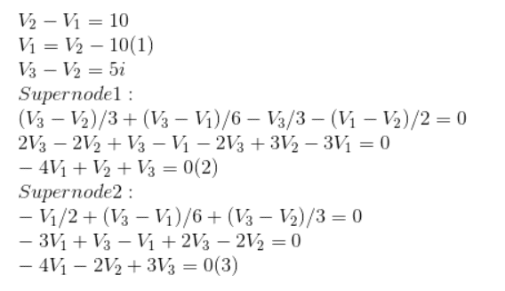

V = I * R
solve (1) , (2) , and (3) to find V1 , V2 ,and V3
V1 = 50/3 = 16.67 V
V2 = 80/3 = 26.67 V
V3 = 40 V
40 - 80/3 = 5i
i = 2.667 A
However , the correct answer is 1.522 A .. I don't know where is my mistake.

Your first equation should be V1-V2=10, since V1 is at a higher potential than V2.
Where does the first term in your first supernode equation come from?
Hint: Once you fix your first two node equations, you can use the ground node for the third equation.
Why did you choose to employ two supernodes when it would seem that a single one would suffice?
