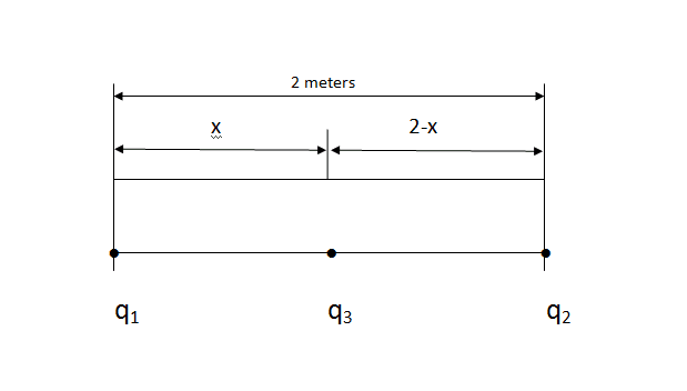

There are 3 charges q1,q2 & q3. Charge q1 is 1.67x10^-10 C and charge q2 is 9.13x10^-6 C. There is no net force on charge q3. x is the distance between q1 and q3 & (2-x) is the distance between q3 and q2. Distance between charge q1 and q2 is 2 meters. Find the distance x.
figure: -
Coulomb's law.
Quadratic equation.
I am getting a very weird quadratic equation and i don't even know that if I am solving it right. Any help would be good. I just want to know the steps to solve it.
What is the equation you get and how do you get it?
Look at the size of the charges q1 and q3. Which of these do you think the charge q2 will be located closer to at equilibrium? Do you think that q2 will be very, very, very close to q1 or q3?
I solved it like this:-
[itex]Fq_3q_1 - Fq_3q_2 = 0[/itex]
[itex]Kq_3q_1/x^2 - Kq_3q_2/(2-x)^2 = 0[/itex]
[itex]Kq_3[/itex] is common and will become zero.
By putting values and further solving it I get quadratic equation.
My answer is [itex]x = -3.9914[/itex] & [itex]x = -4.0086[/itex]
[tex]
q_1x^2 = q_2(2 - x)^2
\\ \frac {q_1} {q_2} = \frac {(2 - x)^2} {x^2}
\\ \frac {q_1} {q_2} = (\frac {2} {x} - 1)^2
\\ \sqrt {\frac {q_1} {q_2}} = \frac {2} {x} - 1
[/tex] Note that the positive sign was selected in front of the radical. This is because the problem requires that [itex]\frac {2} {x} - 1 > 0[/itex].

It looks like you made a bit of an algebra error. The x2 and the (x-2)2 should be in the denominator. As I noted in my earlier reply, q3 is going to be very close to one of the other charges. If q3 is positive, because of the large ratio of q2/q1, q3 will be very close to x = 0, and x can be neglected relative to the 2 in the term (x-2). This greatly simplifies solving for x.
Indeed.
Blast. I just realized that I mistyped the original equation. It should have been [tex]
\frac {q_1} {x^2} = \frac {q_2} {(2 - x)^2}
[/tex] which then gives [tex]
\frac {(2 - x)^2} {x^2} = \frac {q_2} {q_1}
\\ \frac {2} {x} - 1 = \sqrt {\frac {q_2} {q_1}}
\\ x = \frac {2} {\sqrt {\frac {q_2} {q_1}} + 1}
[/tex] which indeed confirms that x should be very small.
@voko x is [itex]8.517*10^{-3}[/itex]
That's what I get as well. Sorry for the initial confusion.
