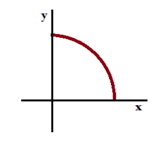

find electric field of a quarter circle charged arc at point located the same distance from all points on the arc
$$dQ = \lambda R d \theta$$
$$dE_x = \frac{k_e dQ}{R^2} cos \theta$$
define charge at an infinitesimal length of arc
$$dQ = \lambda R d \theta$$We only care about the x component of the electric field because the y components cancel due to symmetry
Integrate to add up the infinitesimal parts. A quarter circle means 90 degrees so integrate from 0 to pi/2.$$\int dE_x=\int_{0}^{\frac{\pi}{2}} \frac{k_e \lambda R d \theta}{R^2} cos \theta$$
PROBLEM: I get two different answers when I integrate from 0 to pi/2 and -pi/4 to pi/4. The right answer came from when I used -pi/4 to pi/4.
Doe anyone know why you can't integrate from 0 to pi/2?

If the quarter circle goes from ##\theta = 0## to ##\theta = \pi/2##, would there be a net y-component of the electric field as well as a net x-component of the field at the point where you are calculating the field? I'm assuming ##\theta = 0## corresponds to the positive x-axis.
I think this makes sense. Do you mind explaining why I also get the right answer if i integrate from 0 to pi/4 twice?

Can you see why integrating from ##-\pi/4## to ##0## contributes the same amount to ##E_x## as integrating from ##0## to ##\pi/4##?

Never mind. I think I get it. How could you set up the integral if you wanted to use pi/2 to 0

If the quarter circle extends from the x-axis to the y-axis, so that ##\theta## varies from ##0## to ##\pi/2##, then the integral that you set up will give you ##E_x## when integrated from ##\theta = 0## to ##\theta = \pi/2##. (But think about the sign of ##E_x##.)
How would you set up the integral to get ##E_y## for this case? How would you combine ##E_x## and ##E_y## to get the total electric field?
Why didn't you need to worry about ##E_y## when you integrated from ##-\pi/4## to ##\pi/4##?

Because the y components cancel. I'm confused about how I'd set it up for 0 to pi/2 though to get the magnitude of the electric field. I thought it would be ##cos^2 \theta + sin^2 \theta## but and I got an answer that's kinda close but still off. Any ideas?

Yes, for the case of ##-\pi/4## to ##\pi/4##, the net y component is zero
For this case, what do you get when you evaluate the integral for ##E_x##? Similarly, what do you get for ##E_y##?
Neither of these components will have ##\theta## in the answer. (##\theta## was the integration variable and the integrals have been done.) So, when you combine ##E_x## and ##E_y## to get the magnitude of the total electric field vector, ##\cos^2 \theta + \sin^2 \theta## will not come into play.

I honestly have no idea
You said in your first post that you worked out ##E_x## for the case where ##\theta## ranges from ##0## to ##\pi/2##. But you didn't state what you got for the answer for ##E_x##. What did you get?
Setting up an integral for ##E_y## should be very similar. Can you show the integral that you would evaluate to obtain ##E_y##?
Alternately, using symmetry you should be able to see how ##E_y## compares to ##E_x## without actually carrying out the integration for ##E_y##.
