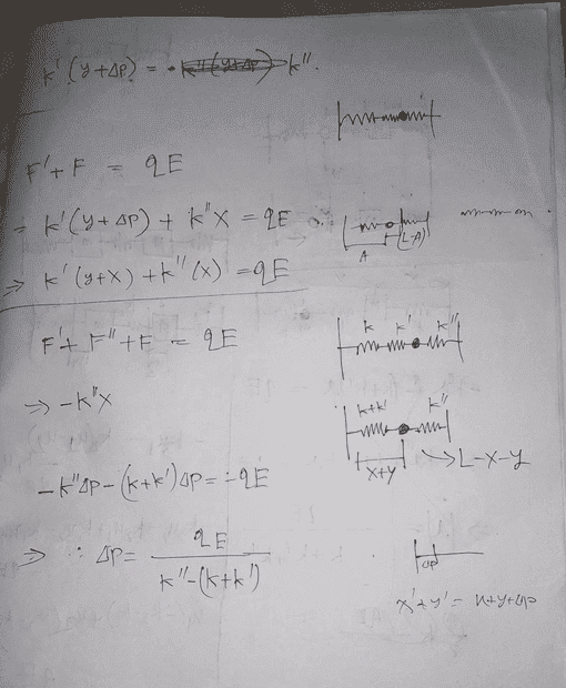

Solution attempt
Find the electric field where? Can you post the full problem statement, and maybe the figure that is in the problem sheet that you are working from? Thanks.
Seems to me you don't like to write a lot. Maybe english is not your mother language ok.
The attachment explains the problem setup but then it offers some choices but it doesn't mention what is the question. It looks like it is asking what is the total potential energy of the system.
And besides that, on your own work you seem to work towards finding the equilibrium position for charge q. Is that what you trying to find?
Yes! It is. That's what I wrote. I was trying to find that value. Potential energy depends on the X²
Likes AF Fardin
Yep
Well I still don't understand your work.
At start you write ##F=qE## or ##k''x=qE##
But after some point you write ##F'+F=qE##
And later ##F''+F'+F=qE##
only one case can be true, or I just don't understand something here.
Likes AF Fardin

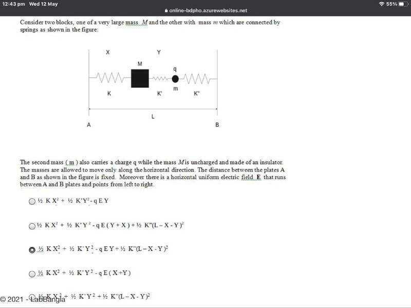

Homework Statement: The second mass (m) also carries a charge q while the mass M is uncharged and made of an insulator. The masses are allowed to move only along the horizontal direction. The distance between the plates A and B as shown in the figure is fixed. Moreover there is a horizontal uniform electric field E that runs between A and B plates and points from left to right.
https://www.physicsforums.com/attachments/e4e2c5e8-5062-4bbf-94a7-55bbd56e393c-jpeg.284961/
Ok fine for the description of the problem setup, but you didn't tell us what is the question asked. Is it "Find the equilibrium position for mass m"?

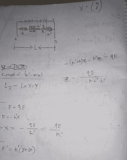

F"+F'+F=qE
This is true I think !
AF Fardin said:
F"+F'+F=qE
At First, I wasn't sure about it!
I was trying and thinking with some roughs!
And that's what made you confused. My final thought is this (F"+F'+F=qE).
Still don't know that my approach is correct or wrong!
Likes Delta2

[6/25, 09:49] AF_Fardin: Both X and Y
[6/25, 09:49] AF_Fardin: Means for both masses
ok so you want the positions of the two masses for when the whole system is in equilibrium. Hold on while I work on my reply (might take a while cause I am a bit busy with other things at the moment.)
Ok I think the correct system of equations is
$$Kx-K'y=0$$
$$K'y+Eq-K''z=0$$
$$x+y+z=L$$
The first equation is from the equilibrium condition on mass M, the second from the equilibrium condition on mass m, and the third is self explanatory
P.S We assume that the springs have zero natural length.

Look at this picture..
1.
$$\frac{1}{2} kx^2 + \frac{1}{2} ky^2 - qEY$$
2.
$$\frac{1}{2} kx^2 + \frac{1}{2} ky^2 - qE(Y+X) + \frac{1}{2} K''(L-x-y)^2$$
3.
$$\frac{1}{2}kx^2+\frac{1}{2}ky^2-qEY+\frac{1}{2} (L-x-y)^2$$
4.
$$\frac{1}{2}kx^2+\frac{1}{2}ky^2-qE(x+y)$$
5.
$$\frac{1}{2}kx^2+\frac{1}{2}ky^2+\frac{1}{2}k''(L-x-y)^2$$
Unfortunately, MathJax isn't working. I had tried with "####" also. I had tried as we use in SE or, CD
Ehm I don't think these options are candidates to the equilibrium position , they are rather candidates for the total potential energy of the system. Try option 2 and tell me if it is correct.

Actually, that was like an exam (Olympiad). My friend had joined to that. Then, he thought his work isn't correct that's why he told me to post it here.
And, no matter what I choose the site won't show correct answer. That's why I/he wants to know the approximation/answer.

Actually, I had gave the whole question and, figure in following picture. You can see the whole question in the image also.
  • #32
Actually I can't see what the question is. I can read only the description of the system. What I can guess is asking (judging from the available options) is "What is the total potential energy of the system?"
Likes Steve4Physics
  • #33
Yes! You got the question..
  • #34
The correct option according to my opinion is option 2.
  • #35
I'm not surprised!
@Delta has (I believe correctly) guessed that the question is 'What is the potential energy?'. But original question does not even mention potential energy!
The meaning of distances X and Y is very unclear. The question-wording does not mention X or Y. And the diagram in Post#1 does not show X and Y properly. (An accurate diagram showing the meanings of X and Y would help a lot.)
Assuming you have posted the full question, then it seems that whoever wrote the original question made a lot of bad mistakes/omissions. Without guesses/assumptions, the question is unanswerable.
  • Love
Likes Delta2
