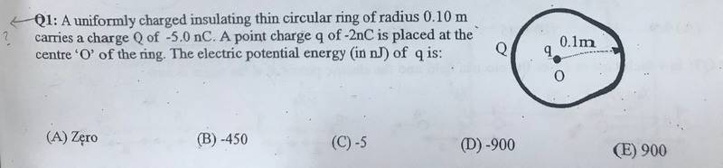

Find the electric potential energy
In summary, the conversation is about solving a physics problem involving the equations V = (kq)/r and V = U/q. The individual provides their attempt at a solution and asks if it is correct. The expert confirms that their answer is correct, but notes that the form of their second equation is incorrect.
Fatima Hasan
319
##V= \frac {kq}{r}##
##V= \frac {U}{q}##
##V= \frac {kq}{r}## = 9*109*-5*10-9 /0.1= -450 V
##U= \frac {V}{q}## = -450 * -2*10-9 = 900nJ
Is my answer correct ?
##V= \frac {U}{q}##
Yes, but the form of your second relevant equation in your last line of calculations is not. Fortunately you did the actual calculation correctly anyways :smile:
