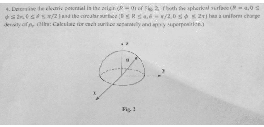

check image
Gauss Law,
I do not have the solutions to this problem so I'm wondering if my attempt is correct.
My attempt at solution: We have two surfaces which we can calculate the area of. I think we can use gauss law to find the electric field and then integrate the E-field to find the electric potential.
So for the circular surface the area is pi*a^2. We get E*pi*a^2 = (1/e0)*ps.
For the spherical surface the area is (4*pi*a^2) / 2 = 2*pi*a^2. We get E*2*pi*a^2 = (1/e0)*ps
Next we solve for V by integrating E with regards to r with the limits being 0 to a.
Am I on the right track here?

I could be wrong, but I don't think Gauss' law is the right thing to do here. For the hemispherical surface you might consider the potential at the centre of a full spherical shell, and use symmetry considerations. For the flat surface, you might want to consider an integration approach.
Likes haruspex
There is no ##r## in ##\vec E## when you write ##E \,\pi a^2 = \displaystyle {\rho_s\over \varepsilon_0}##
And your integration limits are not right: V is not 0 at the origin
@etotheipi is right wrt the appropriate method.
There are a couple of problems with the method you attempted.
The fields vary according to position, yet you seem to have constant values. E.g. at the origin there is no field from the disc.
By convention, the potential should be taken as zero at infinity, so if you want to find the potential at some other point by integrating the field you need to integrate from infinity to the point.

The better approach, which are now using, is to integrate the contributions to the potential from all the little surface patches ds. So the integration range is now over a surface.
You will need to deal with each surface separately. The hemisphere is easy (why?).
See if you can write the integral for the disc as well.

goohu said:
I'm not sure why the hemisphere would be considered easier than the circle.
Since we can figure out the areas without integrating is it ok to just use that?
That should become clear if you answer this:
goohu said:
##V = \frac{1}{4\pi\varepsilon_0} \int \frac{\rho_s}{R} ds ## (1)
In words, what is R in that integral? What does it equate to in each of the two surfaces?
Likes goohu
For the hemisphere R is the distance from origin to each of the ds element, which will be the same at all points.
For the circle the distance will vary. I suppose that is why we need to integrate in this case.
So with this reasoning the hemisphere case should be easier.

Yes for the hemisphere, but your integral is wrong for the disc.
You need to consider an area element for which all parts are approximately the same distance from the origin. What does that look like? What is its area? What is its contribution to the potential at the origin?
My bad, for the circle I think it should be :
## V = \frac{1}{4\pi \epsilon_0} * \rho_s * \int_0^a \frac{2\pi R}{R} \ dR ##
Yes.
