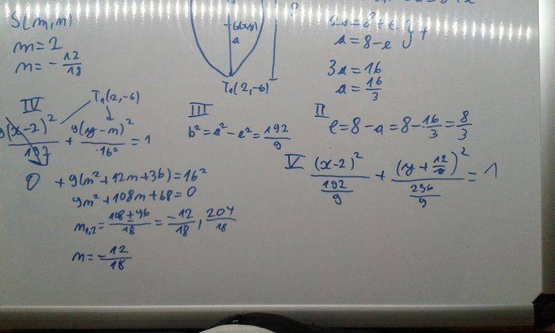

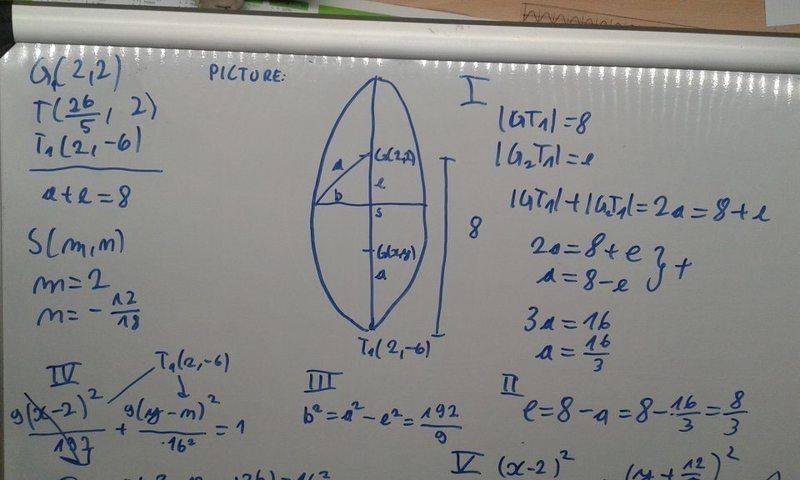

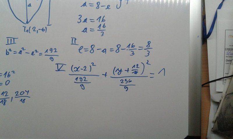

So what I tried doing was:
From the definition I know that the sum of the distance from each of the two fucoses to the outer line is constant and it equals 2a. We are also told that a+e=8. From the picture we can clearly see that the distance from the upper tocus to the vertex equals a+e( or 8). And we also know that 2a=8+e solving both equation we get that a=16/3 and e=8/3. Then I used the pitagoras therom to get b( the minor axis) and from then on I used the point (2,-6) in the ellipse equation to get the center( later I realized that I could just substract e from the first focus). I got the final equation, however when I go to check it with the point (26/5,2) I don't get the right answer.

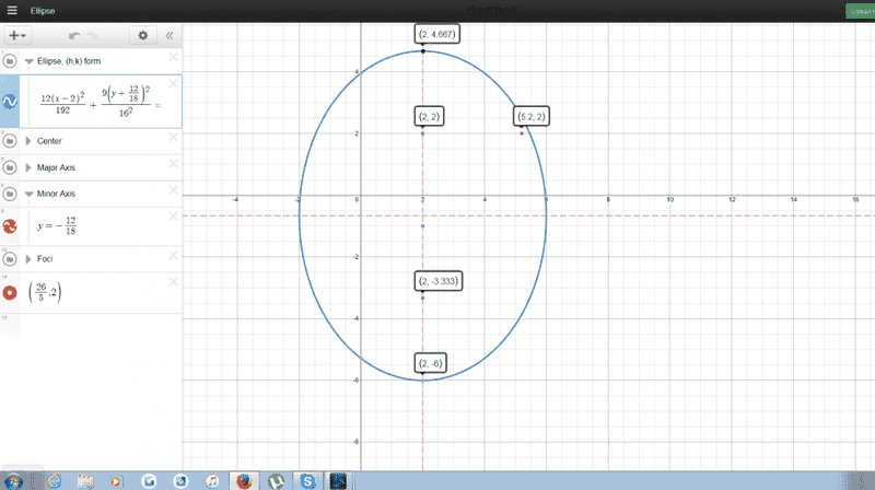

Below I will include the picture of the ellipse I made using the desmos graphing calculator
as you can see the point does not lay on the line.
I would really appreciate it if you could check my work and find my mistake.

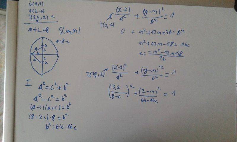

and the distance from |GT1|=8 and |G2T1|=a-e so the distance from both focuses to the point T1 is 8+a-e and this equals 2a. Aha . . . I see it know will try to do the problem again

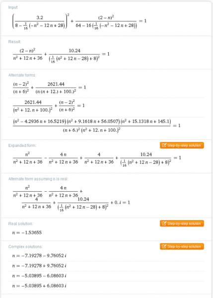

Ok so now i spend quite a bit if time on this problem. I did it from the start again and this is what I got:
then I used wolfram alpha to solve this equation and got this
only 1 soultion was real so I used that one to calculate both of the axis. However once again I got an ellipse but the point (26/5,2) was not on it. Do you guys think it's possible that the instruction are wrong because I'm completely lost at this point

I assume you meant to write that the point was not on it.
Without using the location of the point on it, you do not have enough information to find the equation, so I do not understand what you did.
Likes Matejxx1
Since the vertex is also a point on the ellipse, you know two points. You also know one focus, and the other focus must be collinear with the vertex and the first focus. It is not hard to find the position of the other focus from that... just Pythagoras.
