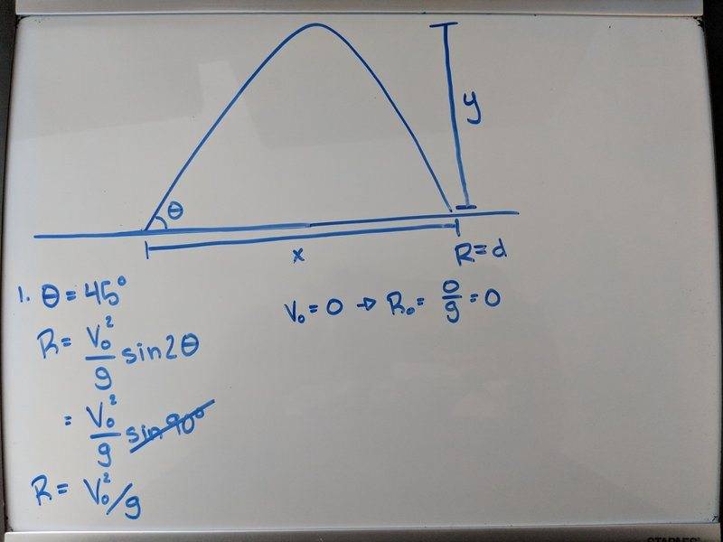

bornofflame said:
A certain football placekicker can kick the ball a distance d if she kicks it at 45°.
a. Find an equation for the velocity of the kick. (You may use the range equation R = (V02/g)sin2θ.)
Let's start with this part. Can you draw a diagram showing the trajectory of the football and all of the information given in the problem (the angle θ, the angle of the kick, the distance d, the range ##R_0##, the velocity of the kick, and the initial velocity ##V_0##)?
Here's what I came up with.
Although, distance should be the arc, while range is the line along the ground, yes?
And since the ball is beginning at rest V0 should be 0 m/s, I think. But I'm not sure because I'm wondering if V0 actually refers to the time just after the ball is kicked. If so, that would change R0, which I have as 0 because of V0.
If think you have the the distance d correct in your diagram. You would normally measure the distance kicked as the distance along the ground.
##V_0## must means the speed at time ##t=0## and it is up to you to choose the instant when t is 0. If you say it is before the kick, then you have to figure out the momentum transferred to the ball by the kicker's foot. The ballistic equations don't help you with that, so it's better to skip it and say that ##V_0## is the speed at the instant after the kick when the only force acting on the ball is gravity.
You should show ##V_0## in your diagram. Drawing the diagram and labeling it with everything you know really helps you to figure out the relationships between the variables. I recommend it as the first step in every problem you solve.

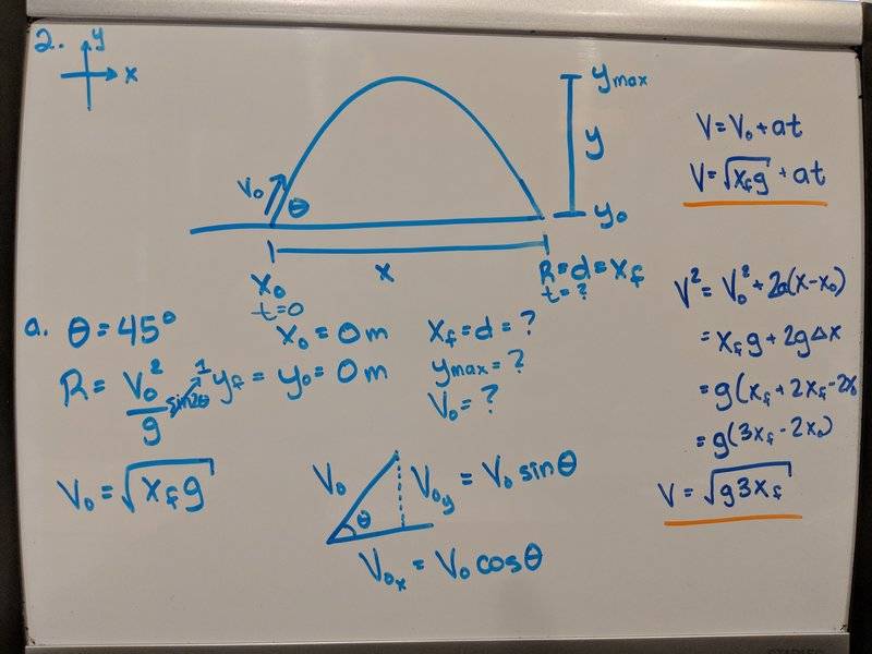

Alright. That makes sense. I thought that d was along the ground at first and that is why I made it equal to R, but then I was thinking that the problem was actually referring to the distance traveled through the air. I will fix my diagram to reflect this. You are right. The diagram should be the first thing done. For whatever reason, it's not quite habit yet. I will have to respond after tutoring, however. Thank you for the direction.
I hope that this is up to snuff. I put in everything that I have and labeled the items in more detail.
I also realized that I probably lost the couple of points on my answer because I failed to consider the value of the angle as 45° and left the θ as a part of my final answer, when it could have been further simplified to V = √(xfg) + at. Should that be further simplified by replacing a with g, since that is the only acceleration in play, non?
So, with that in mind, instead of uploading multiple pictures, I added the simplification to whiteboard. So, now I have two possible equations for V. I think that, since we don't know what t is at all, the latter equation is the one that should be used. Correct me if I'm wrong.
The diagram looks good, except that you have not labeled the velocity of the kick. When you do that, I think the correct result will become clear to you. Also, you are given the value d for the distance the ball is kicked, but you have not substituted it in your equations.
I'm not entirely sure what you mean by labeling the velocity. Are you referring to V at the apex when it is 0? Or the final V where it also is 0?
As for d, I was not sure where it went, but after reading what you said and looking back at the diagram, I think I understand: wherever we would write xf or x, we would write d instead which would end up giving the answer V = √(3gd). We could do the same with R as well, since the range is the distance traveled, which would allow us use d = (V02 / g)sin2θ. Or is that only for R? I ask, because I'm not sure where to keep the d and leave the x, since the destination equation for b has both.
By substituting d for R and solving for g after solving for x and y and then substituting x into y, I am able to reach the final equation. The mathematics makes sense to me, the application, however, is still not entirely clear. Again, referring more specifically to when to use d versus x.
The question asks you for an equation for the velocity of the kick. When does that velocity occur?
Yes, R, ##x_f## and d all represent the same distance, as you have shown in your diagram. Your answer for V is not correct, though.

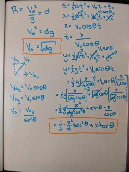

bornofflame said:
I believe that it is referring to velocity from the time that the ball is kicked until the time that it hits the ground; so anytime in between t = 0 and tfinal. If I'm right then an equation for the velocity at any time in between those two times is what is being asked for.
Given the ambiguous wording of the question, I think that is a reasonable interpretation, and now I understand why you did what you did. However, I suspect that what is really being asked for is the initial velocity ##V_0## at the instant after the kick.
I think that if you check some of the points in your diagram, which appears to be correct, against your equation for V, you will find your equation does not give correct answers.
Here is the main problem with your solution approach. You have attempted to use the energy conservation equation ##V^2=V_0^2+2g(H_0-H)## or equivalently, ##\frac12mV^2+mgH=\frac12mV_0^2+mgH_0##. This equation says that sum of kinetic energy (due to motion) and potential energy (due to height) is constant over the trajectory. Do you see why the way you have used it is incorrect?

bornofflame said:
Unfortunately we skipped over the chapter on energy, though we'll be going back to it after we finish momentum; I don't know much at all about kinetic energy and even less about potential right now. I recognize the formula ½mv2 and that kinetic is energy from motion (I think). Even without that, however, what you're saying as far as the energy remaining constant seems quite unlikely. I imagine that as soon as the ball soars through the air it is losing energy that it gained(?) from the force of the kick.
It does lose kinetic energy ##\frac 12mV^2## as it rises but it gains potential energy ##mgH##. The principle of conservation of energy says that the total energy is constant.
bornofflame said:
Is that why the way that I used it is incorrect?
The reason the way you used it was incorrect was that you used horizontal distance ##X## in the equation rather than height ##Y##.
bornofflame said:
I chose that equation because at this point we've been told that the equations dealing with constant acceleration, of which this was one, are pretty much interchangeable and it was easy to take the V02 from the range equation and transplant it into this one.
That's true, you can get to the same result using different ballistic equations.
When you work part b), you will find that you need to know ##V_0## as a function of d. That's why I say you need to be solving for ##V_0## in part a).

bornofflame said:
Ah. Ok. That makes sense. Since the velocity in the x-direction is not changing at all, but velocity in the y-direction is, right? Even if I had plugged it into the equation using the proper direction, I wouldn't have gotten any further because I was using d = xf.
As soon as I solved for V0 in terms of d I got what I thought was the answer, until I realized that I have addition in my answer where the desired equation has subtraction. So now I need to figure out where I went wrong with that.
In which direction does the force of gravity act?

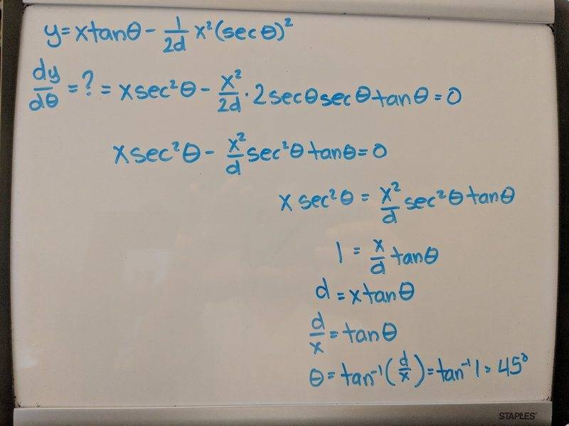

Ah. Understood. I didn't realize that I could take the sign of acceleration due to gravity into consideration already. Usually, I am only concerned with it when plugging in numbers.
So that said, for part c I have this:
Where I took the derivative and set it equal to zero and solved.
I'm a little rusty on finding maxima but I believe I've done it correctly.
I did it this way because if I take xsecθ out then I would need secθ to equal 0 which can never really happen.
You have done just fine except for the last step. The question asks for the angle that gives the maximum height at distance x, not at distance d.
Ah! Thanks for pointing this out.
So then that would be tan-1(d/x) as x gets bigger which means that d/x approaches 0 as x gets larger and we would have tan-10 which would result in θ = x90°, meaning some multiple of 90. Neither 0° or 180° works, however, since that would result in a kick straight off to the side in either direction resulting in little or no height. A kick straight up would seem to fit with the idea of the most height and since the distance traveled in the x-direction is very small, this seems to fit. Hopefully my logic is sound.
I like that you are testing your solution, but you have one detail wrong. ##tan^{-1}(0)## is not 90°.
Try this case (you already know something about it): What happens when ##x=d##?
When x = d then we have tan-1(1) which evaluates to 45°. So looking at the inside is the important bit. We have d/x. d represents the entire distance that the ball has traveled and x is the point at which V = 0 m/s. So x must be less than d. But if x approaches 0 then we are at a height of 0 or almost 0 which isn't what we want either. So the value of θ is somewhere between 45° and 90°.
This actually ties into a discussion over the problem that I was able to have at school today, I think:
If we take the path of the ball to be symmetrical where the point at which the Vy = 0 is equal to half of d and plug that into our x, that would give us tan-1(d/(d/2)) = tan-1(d*(2/d)) = tan-1(2) = 63.4°. Is that sound?
I think you have misunderstood something. You found an equation for ##y(x,θ)##. Then for a given ##x##, you found
##\begin{matrix}argmax\\θ\end{matrix}y(x,θ)=tan^{-1}(\frac dx)##
What that means is for a given ##x##, ##tan^{-1}(\frac dx)## tells you the launch angle to achieve the highest height at a horizontal distance ##x## along the ground from the launch point. You are talking about it as though it would give the highest point in the trajectory, which is not the case.
So for example at distance ##d## from the launch point, the highest height you can achieve is zero. That is consistent with what you know about the range equation. The longest horizontal distance x you can achieve is ##x=d## and that occurs at ##θ=45°##. If you fire at 44° or 46°, the projectile will fall back to a height ##y=0## at ##x < d##. If it continued to fall after that, at ##x=d##, ##y(x)## would be less than 0.

Sorry for long time in between posts. All of my upcoming exams are within days of each other and I've been swamped.
On topic: Apparently we weren't looking for an actual angle, which is why it was so difficult, but, rather, the expression that we had already found. So this can all be considered solved.
Thanks again for all your help!
